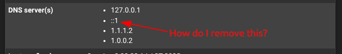

      Please bear with me if this is a noob question, I'm learning pfSense and have only been using it for a couple of weeks.
      I can't find where this was added. I had IPv6 disabled globally. How can I remove that entry? thanks.
          @dennypage Thanks. I know that. I Don't want to see that extra line in the dashboard. How can I remove it?

            @hydn said in How can I remove this IPv6 DNS entry? (post 2.8.0 upgrade):
            To my knowledge, you can’t. Just like you can’t remove 127.0.0.1.
              Gertjan @hydn
              You need two "/" and here is the info where to place them :
              Change
              		$dns_nameservers[] = $add_v6_brackets ? '[::1]' : '::1';
              for
              //		$dns_nameservers[] = $add_v6_brackets ? '[::1]' : '::1';
              Removing '::1' is bad because unbound 'needs' it - I guess. Have a look at the PHP script I've showed above, why it's included.
              Be ware : removing ::1 from /etc/resolv.conf, and thus stopping it from showing up in the GUI dashboard ... not sure if that's a good idea. Be ready to face issues.
              Another method, probably way better :
              Edit the dash board, the System Information widget script file, and remove the line that shows the '::' : just dn't show it anymore.
              After all, the kernel will still be IPv6 active, the firewall rules (not the GUI, I mean the real list of rules : see /tmp/rules.debug ) will still contain IPv6 rules, etc.

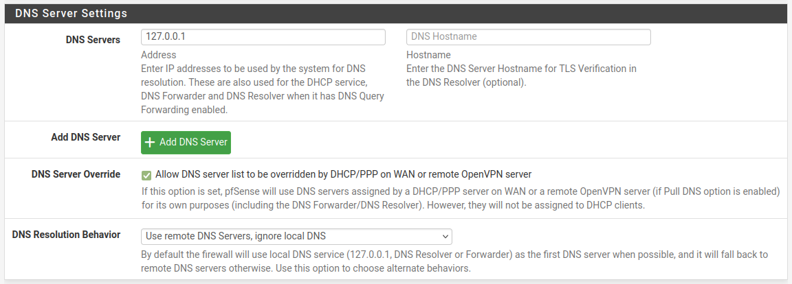

                  A (perhaps) cleaner way is to set the DNS behaviour to 'Use remote, ignore local'. Then add back 127.0.0.1 like:
                  But remember to remove localhost there if you ever change back because it will throw an error trying to add it twice.
                  Or just ignore it since it's not a problem. It's just v6 localhost, the same as v4 localhost isn't a problem.

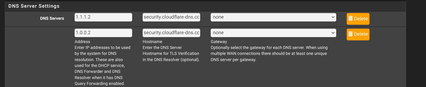

                            so the description here says:
                            (still current setting, my wife is streaming on TV, and if the network goes down one more time I'm pretty sure she'd divorce me.)

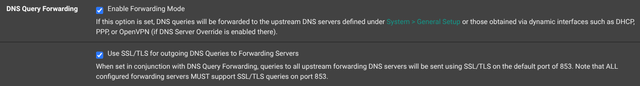

                            I do have forwarding enabled:

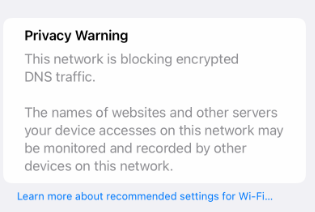

                                    @stephenw10 Ok I understand. I enabled it between local clients but I get a warning on my iPhone when connecting to the hotspot about privacy.
                                    I can connect to it, and it works but just warns about privacy.

                                    8b671a8c-ccd4-48d7-a680-8728408422be-image.png Edit: Also according to this it would mean DoT over 853 is indeed working?.
                                    • stephenw10S Online
                                      Yes port 853 is DoT. You could also check the firewall states in Diag > States for that.
                                      The iphone is probably trying to connect to some remote servers dircetly. Are you blocking external DNS for clients?
                                      hydnH 1 Reply Last reply Reply Quote 0
                                      • hydnH Offline
                                        hydn @stephenw10
                                        @stephenw10 yes you are correct. It was to their own 853 servers (apple’s pricate browsing feature). I’m not sure exactly what I changed but the warning is gone now.
