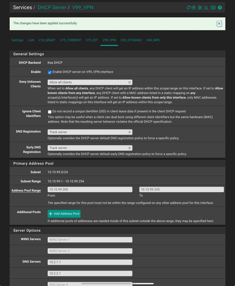

          Thanks again for the reply. It was maybe a fw rules issue.
          V99_VPN uses the 2 VPN servers DNS.
          I can now see the traefik client go over vpn dns and seems ok now.
          Does this look like a good setup to you?
          I’m just learning pfsense. Thx a lot

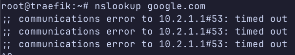

                    @keyser mmh now it’s not working again. I’m not sure if the issue is with NAT rules. I haven’t changed anything and nslookup go on timeout with state no traffic.

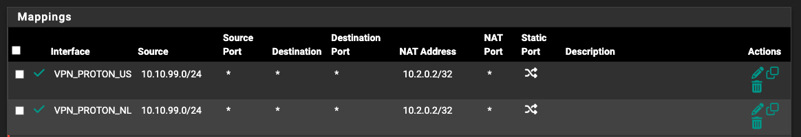

                        What I’m now trying to do is to isolate part of the network by using a VLAN and route all its traffic—including DNS—exclusively through the VPN. From a privacy perspective having VPN traffic and DNS within the VPN seems to be the safest approach. I’m fine giving up some control and filtering provided by pfBlockerNG and popular public DNS.
                        I’m still not quite sure how to set this up properly. I tried configuring the VLAN’s DHCP server to hand out the VPN’s internal DNS IPs (10.2.1.1 and 10.2.2.1) for the 10.10.99.0/24 subnet. It looked like it was working earlier, but now DNS queries are timing out.
                        I have disabled DNS Resolver on the vlan 99 interface.
                        The 2 Gateway VPN IPs are used as dns servers on my host /etc/resolv.conf
                        nslookup timeout

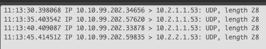

                        Traffic going out from VLAN to VPN DNS
                        traffic seems coming back from the VPN (this is correct as I have 1:1 NAT on 10.2.0.2 to 10.2.1.1)
                        I suppose on the VLAN I should see traffic response coming in from 10.2.1.1 but I do not and that is why I see "timed out".
                        The nat seems to work I think. I am confused on why the DNS response is not properly routing back to the client
                        my 1:1 NAT
