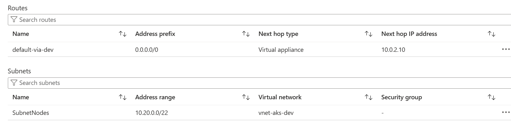

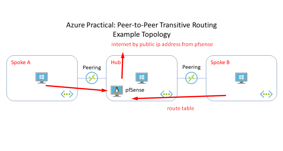

      I have 3 subscriptions, I got them connected to hub from peering connection, that works properly I can communicate normally, so then I want to use a network virtual appliance from pfsense to establish internet connection from the hub to the spokes subscriptions vnets, basically I install pfsense plus from market place in azure into a subnet inside the vnet of the subscription of hub, I enable public IP to the same nic of the private ip that from the vm, I set forwarding on the nic too, then once is up in running with the suggest information of pfsense I get inside the GUI and I move forward to the setup of the application as default, finish the setup, then I move to the spokes vnets and configure the route using this configuration.
      default-via-dev
      0.0.0.0/0
      Virtual appliance
      10.0.2.10 {this ip is from the interface that use a internal ip to connect even if I set a public ip address}, and associate a subnet of the spoke vnet, later I create a vm inside that subnet of the vnet spokes but I'm unable to get access to internet. Can someone please help me to check what is missing on my configuration? thanks

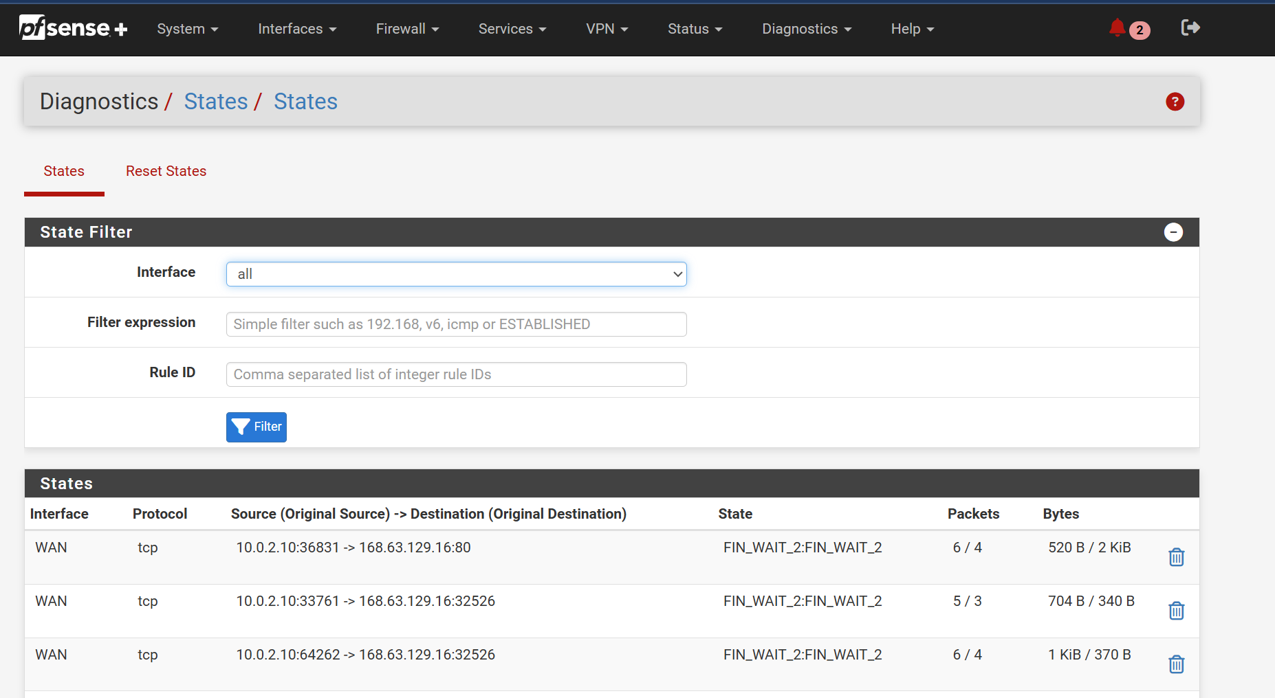

        Check the state table in Diag > States when you try to connect out from one of the spokes. What states do you see created?

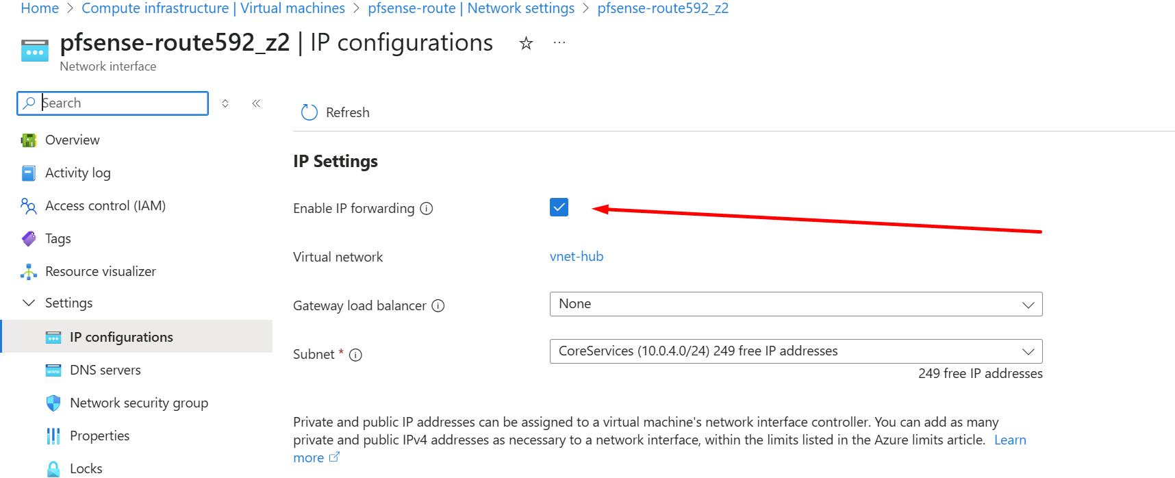

        Did you enable IP Forwarding in Azure for the pfSense VM?

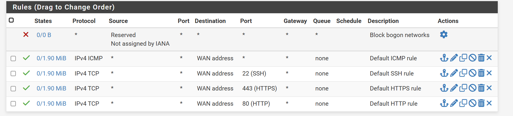

          I just left the rules as default,
          nothin from 10.20.0.0 my ip from test vm on spoke subnet is 10.20.4.4

          Did you enable IP Forwarding in Azure for the pfSense VM? yes

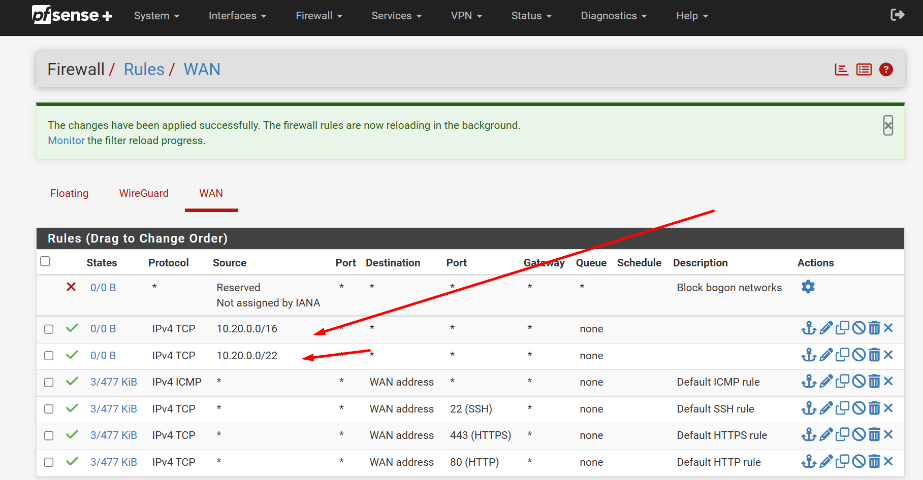

            OK you will need to add more firewall rules on the WAN to allow traffic from the other subnets if you only have one NIC there.
            But I would add another NIC and route the traffic to that instead personally.
            If you don't enable IP Forwarding in Azure it will just drop traffic that isn't to or from the VM IP directly. It can't route traffic from other subnets as you are trying to do here.
            • H Offline

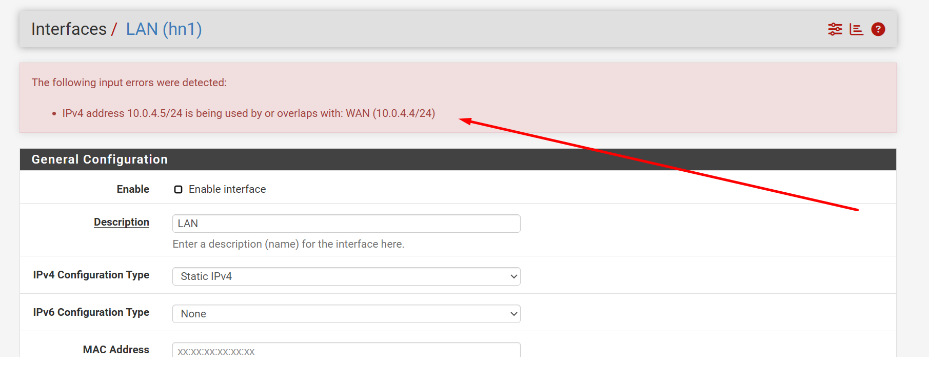

              Forwarding is enable, I setup another nic in the same vm but still not seeing the problem. with the new nic if I try to setup and local ip address I got this error
              soo both are in dhcp,
              I add the subnet of the peering connection and the subnet of the spoke subscription
              still not working, no internet in the vm or the spoke subscription. anything else that I can check?
                You need to add the new NIC in a different subnet from the WAN and the route traffic to that from the other locations. If you chose to use two NICs at least. Which I would.
                Do you see any in coming traffic in the states yet? Or in a pcap on WAN?

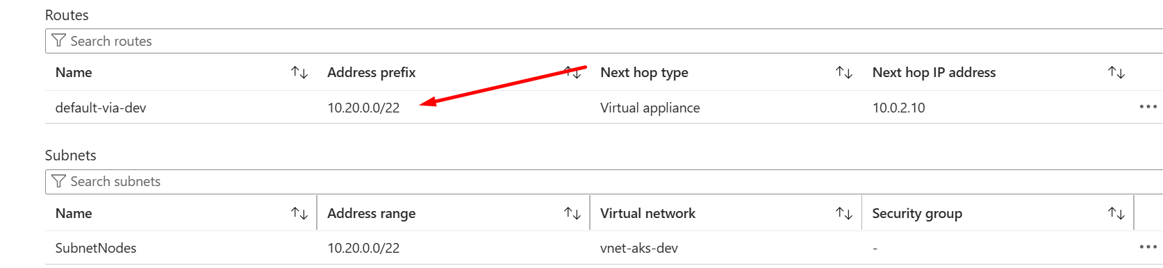

                  @stephenw10 ok I got to solve the problem changing my source of the route table URD from 0.0.0.0/0 to my subnet from my spoke subscription 10.20.0.0 from that is working the test vm with internet. now I will test performance to connect a cluster ks8 from each spoke. thanks for the support .
