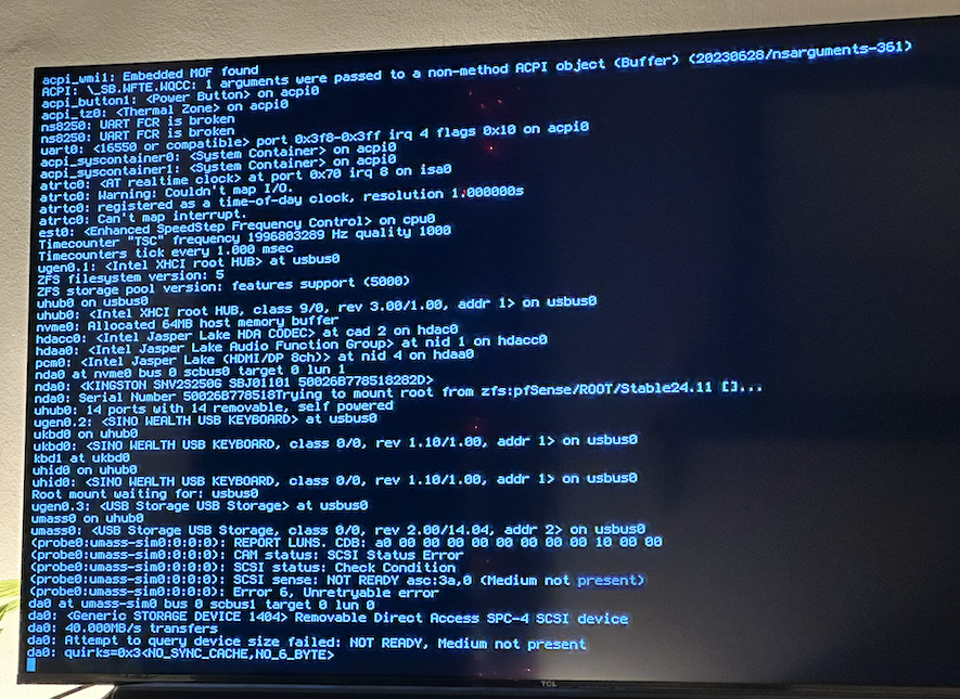

      Hey there! I run PFSense on a Topton 4x 2.5Gb ethernet mini computer from AliExpress and it's been pretty stable for pretty long, save some early issues with setup and interfaces. But I just left the house for a few days and saw my power go out for longer than my UPS could manage which resulted in my router going offline and it seems when it came back up when power was restored the boot failed. Once I got home and was able to reboot I saw it hung most times on a series of issues, but frequently:
      da0 at umass-simo bus a scbusi target a lun a
      da0: ‹Generic STORAGE DEVICE 1404> Removable Direct Access SPC-4 SCSI device
      da0: 40.000MB/s transfers
      da0: Attempt to query device size failed: NOT READY, Medium not present
      or what looks like a SCSI/USB error. I'm running my boot/pfsense disk on a NVME drive which has passed it's S.M.A.R.T. tests and I've shut off USB drive booting in the BIOS.

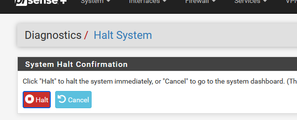

        Exactly like you shut it down in the GUI with :
        This way of shutting down is somewhat mandatory.

        That said, this message
        might also be an indication that the drive is somewhat EOL.

            It should not show, after several seconds after boot up :
            @rmeskill said in Terribly slow boot times and frequent boot freezes:
            the drive / device (this is the boot drive, right, not some other drive ?) is detected alright.
            But the OS asked a question, and it doesn't answer with the "wait a moment, not ready yet", but a, imho, more scary : "NOT READY, Medium not present". Afaik, the 'medium' can't be removed ^^

                    That error from da0 is probably unrelated. It's not the NVMe drive. I'd guess that device has an SD card slot or something similar. It has no card in it so reports that media error.

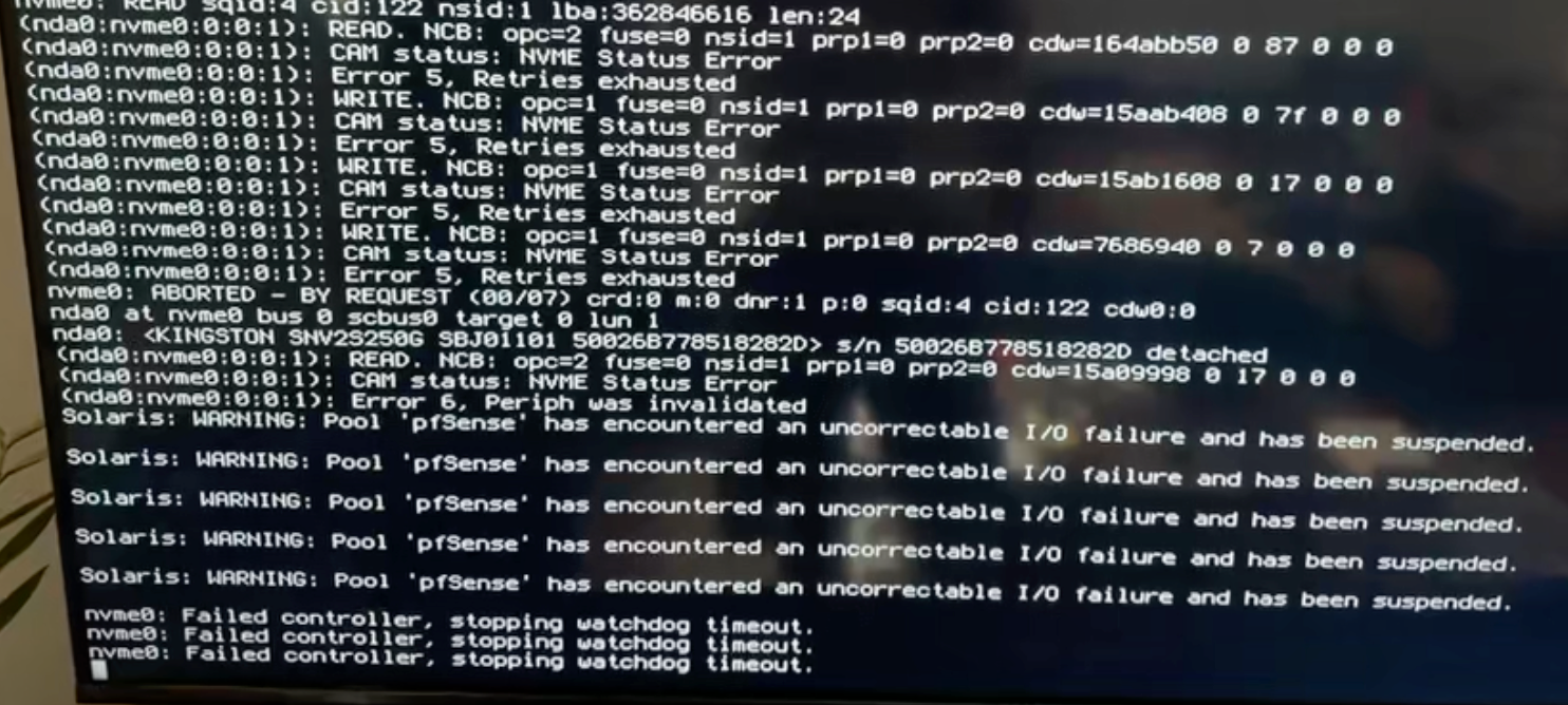

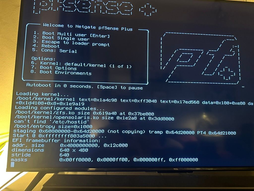

                          rmeskill @stephenw10
                          Either really early doors here:
                          b2ba77c6-f177-4e55-9938-c097397b0dab-E4D0756E-4F8E-4538-8FA9-0D4AE3519DE7_1_105_c.jpeg
                          or here:
                            Hmm, so in both those situation is does eventually boot?
                            We've seen some other device hit those but AFAIK they never boot from there.
                            Try booting verbose to get more output from the 2nd scenario.
                              @stephenw10 that's actually a good question, but I think no. Sometimes it freezes there and sometimes it boots. But I just had another power cut and ended up with this screen, it looks pretty damning for the NVMe:
                              Anyone have any suggestions for a good value/quality NVMe replacement?
                                Urgh, yeah that's not good. It's difficult to break ZFS just by removing the power. So, yes, could be a bad drive.
