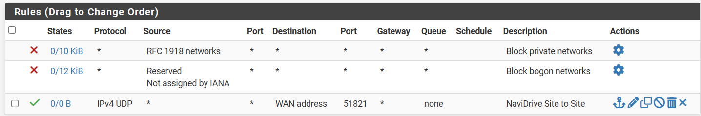

              MartynK @patient0
              @patient0 I hope this is what you want.
              I need to split the uploads of two posts.

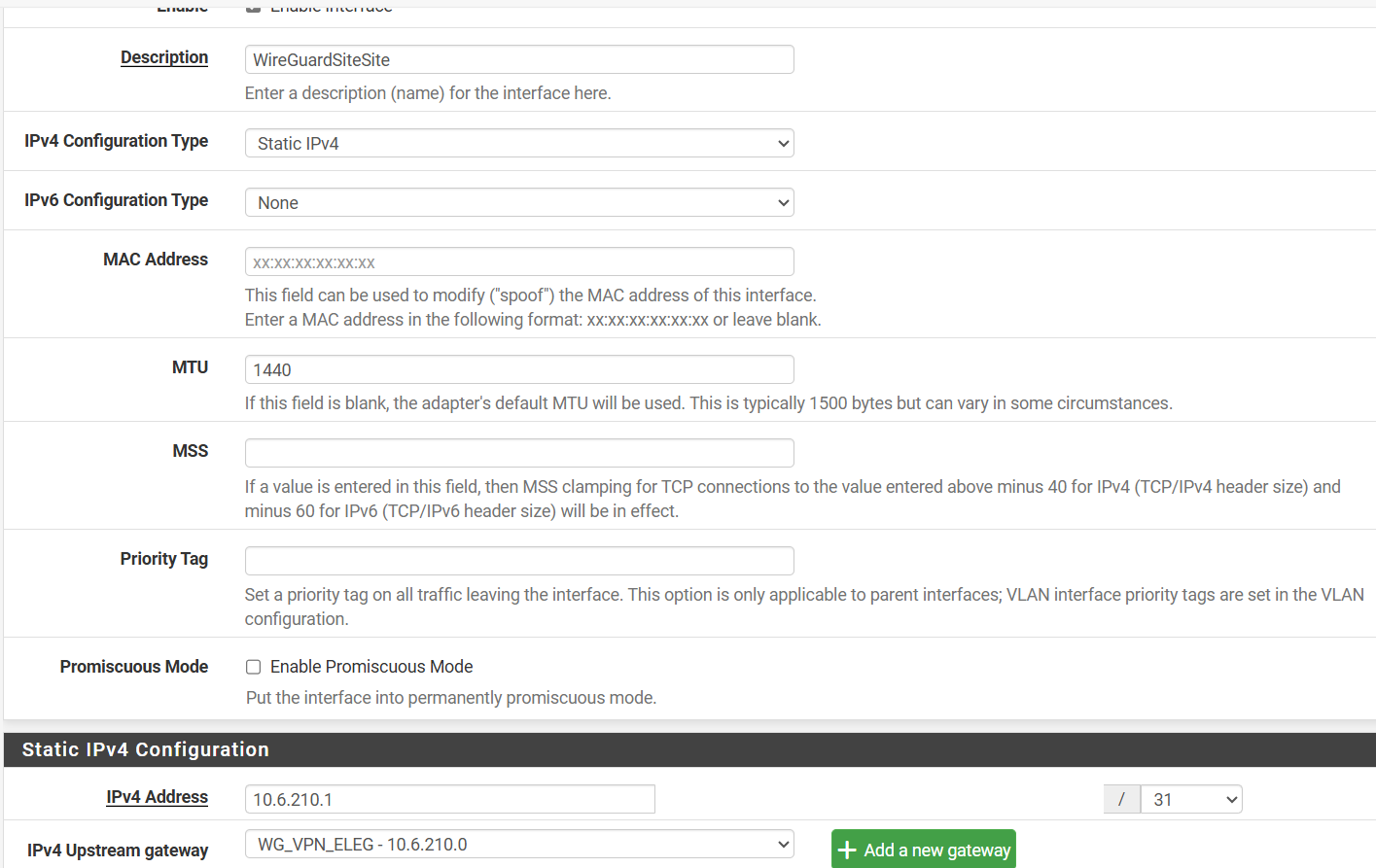

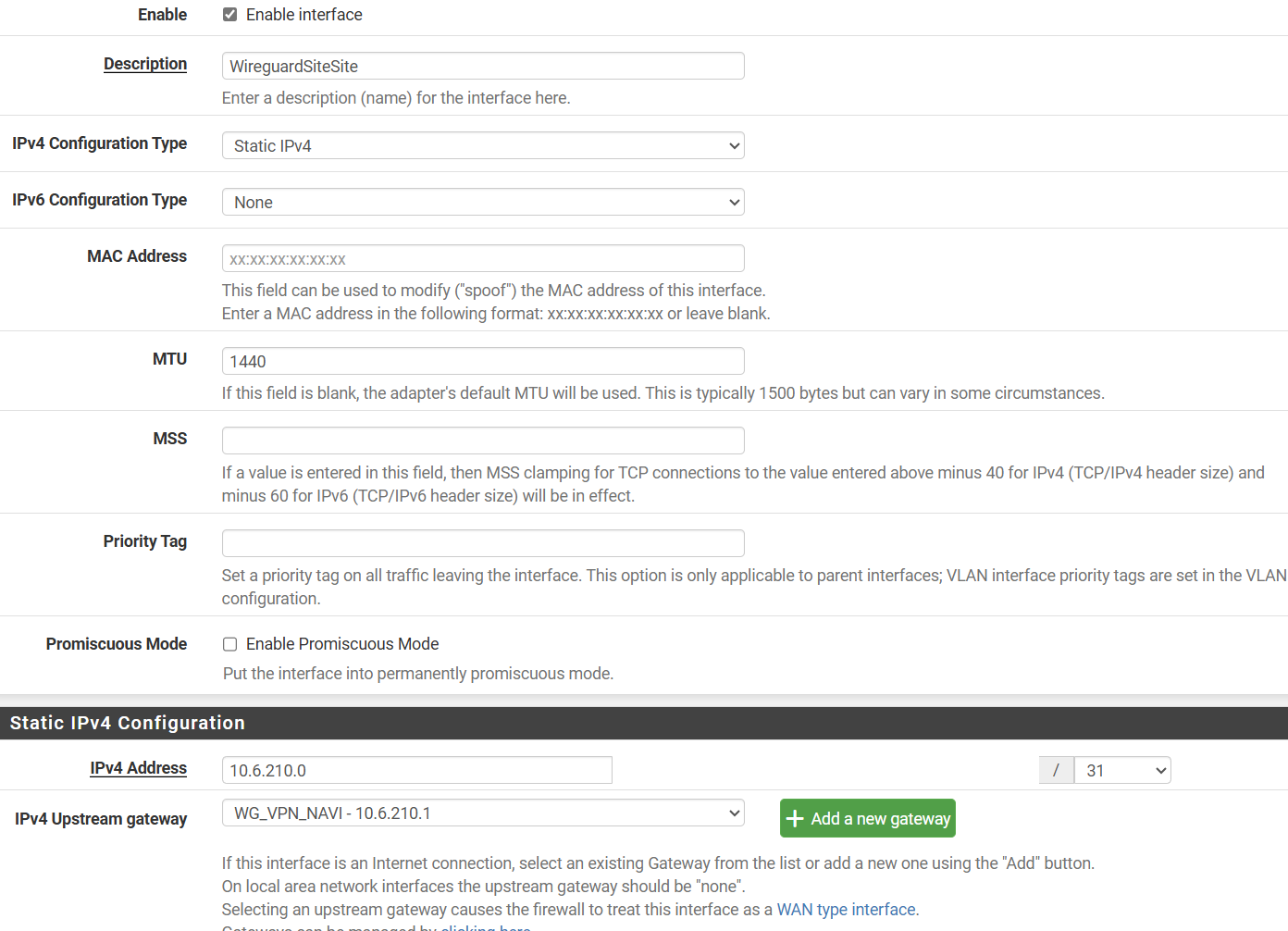

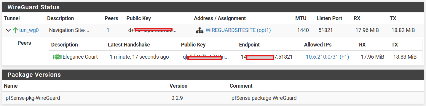

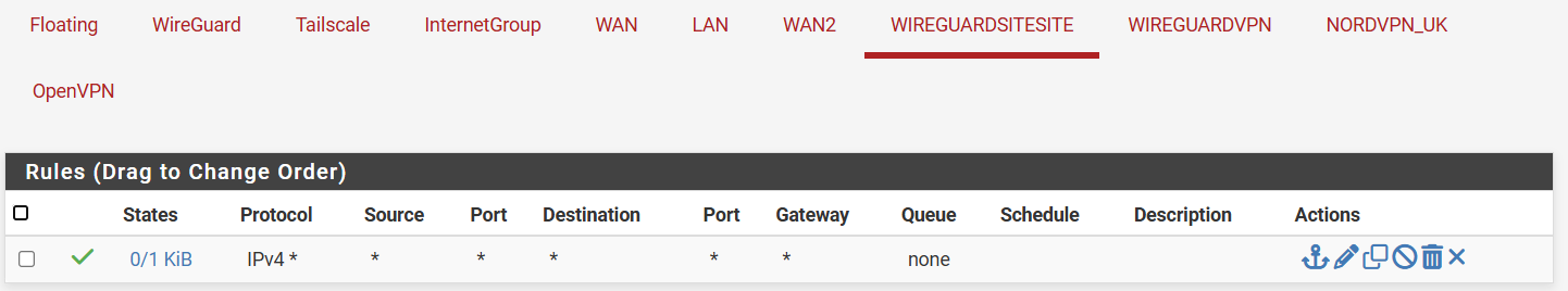

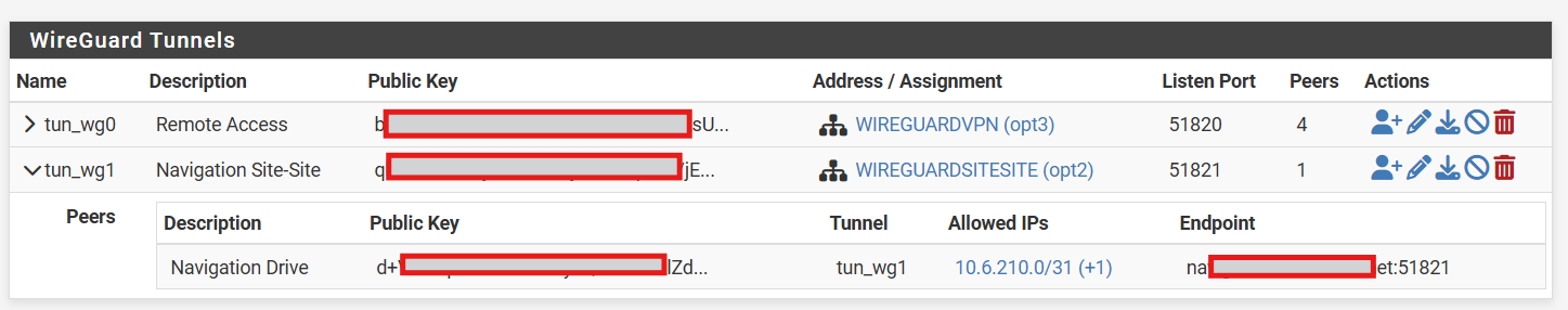

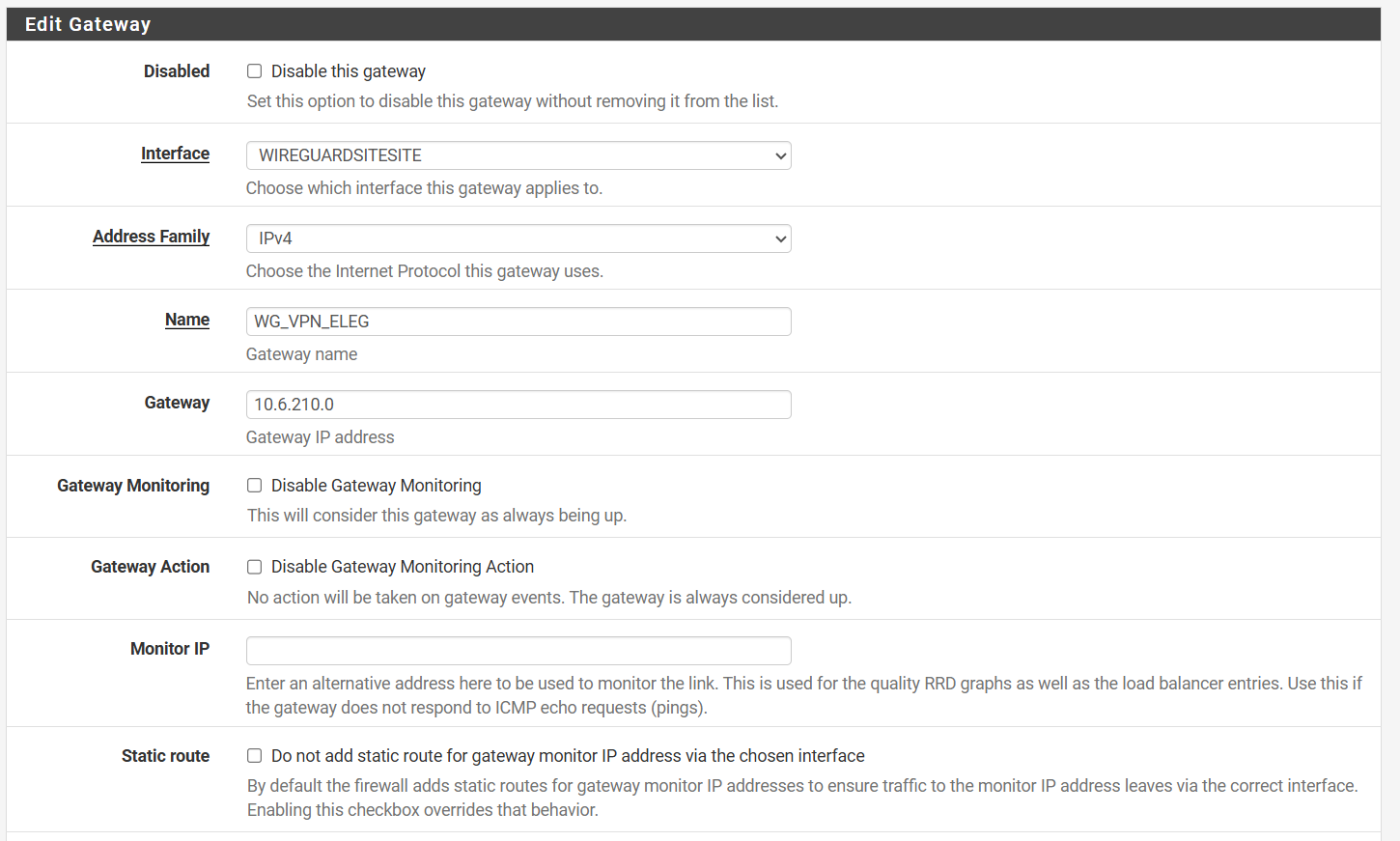

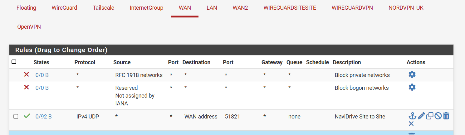

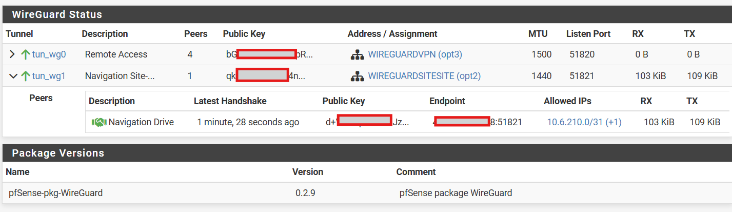

              Main Site

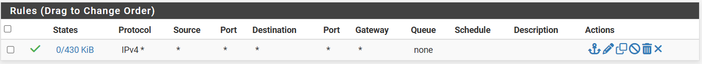

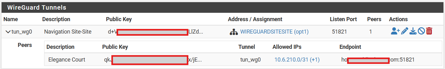

                Remote Site
                • patient0P Online
                  patient0 @MartynK
                  @MartynK Mmmmh, it does look ok. And looking at the RX and TX on the remote, it looks as some traffic is leaving over the tunnel. But the same values on the main site are very low.
                  I assume you have no other 10..../xx route that overlaps with with 10.6.210.0/31?
                  And do you have added static routes for the the local network(s) you want to route? And the networks you want to route on the main site and the remote site do not overlap?

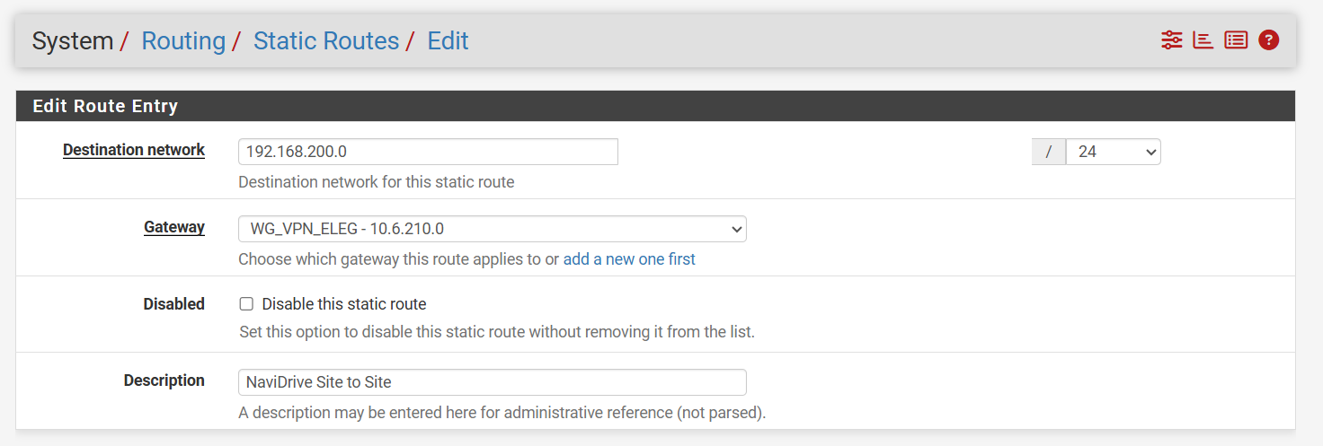

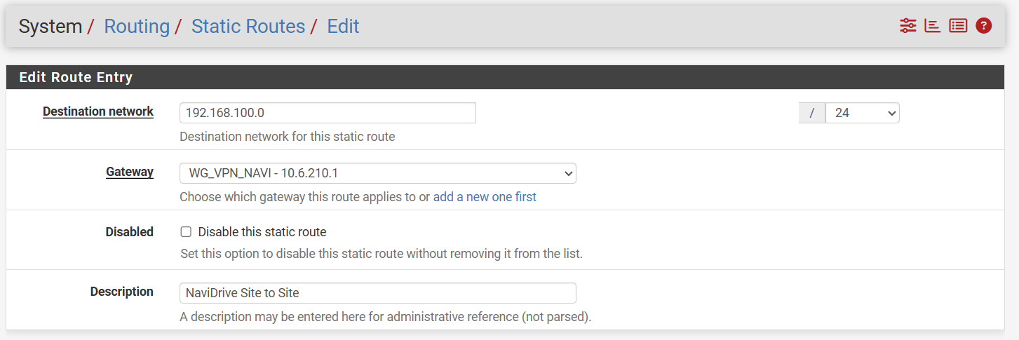

                    The static routes are there as follows:
                    Host:
                    Remote:
                    I am wondering if there is an issue with two WireGuard instances running, one for my remote access and another for the site to site as per:
                        No, multiple Wireguard tunnels on different ports are absolutely fine.
