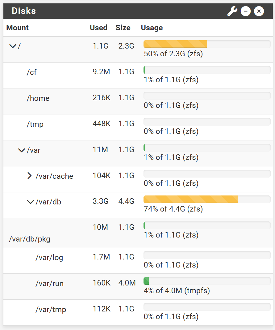

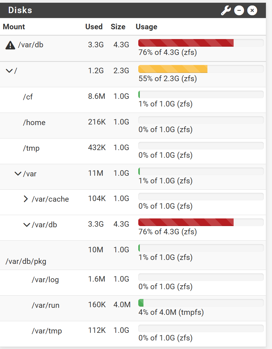

      Hi All:
      I have seen a steady loss of disk space, to the point that the /var/db disk display is now red with 76% usage. Also seeing high CPU usage for no apparent reason. Any idea the root cause(s) or possible fixes? Thanks in advance!
      -Andy

        @andy58 said in 2100 running 24.11 low on disk space:
        3.3G /var/db
        Why didn't you go one level lower ?
        I place my bets on : you have pfBlockerng installed, and went pretty wild with IP and DNSBL feeds and these list eat disk space like cake. The solution : delete some feeds.
        If thuis is not the case : what is the folder that takes up most of the Gbytes ? The name of the folder is the answer to your question.
        Also: You have pfSense Plus. Go here - edit : System > Boot Environments - and check if you have ZFS
        that you don't need anymore.
          Yup check System > Boot Environments for old ZFS snaps you no longer need and remove them.

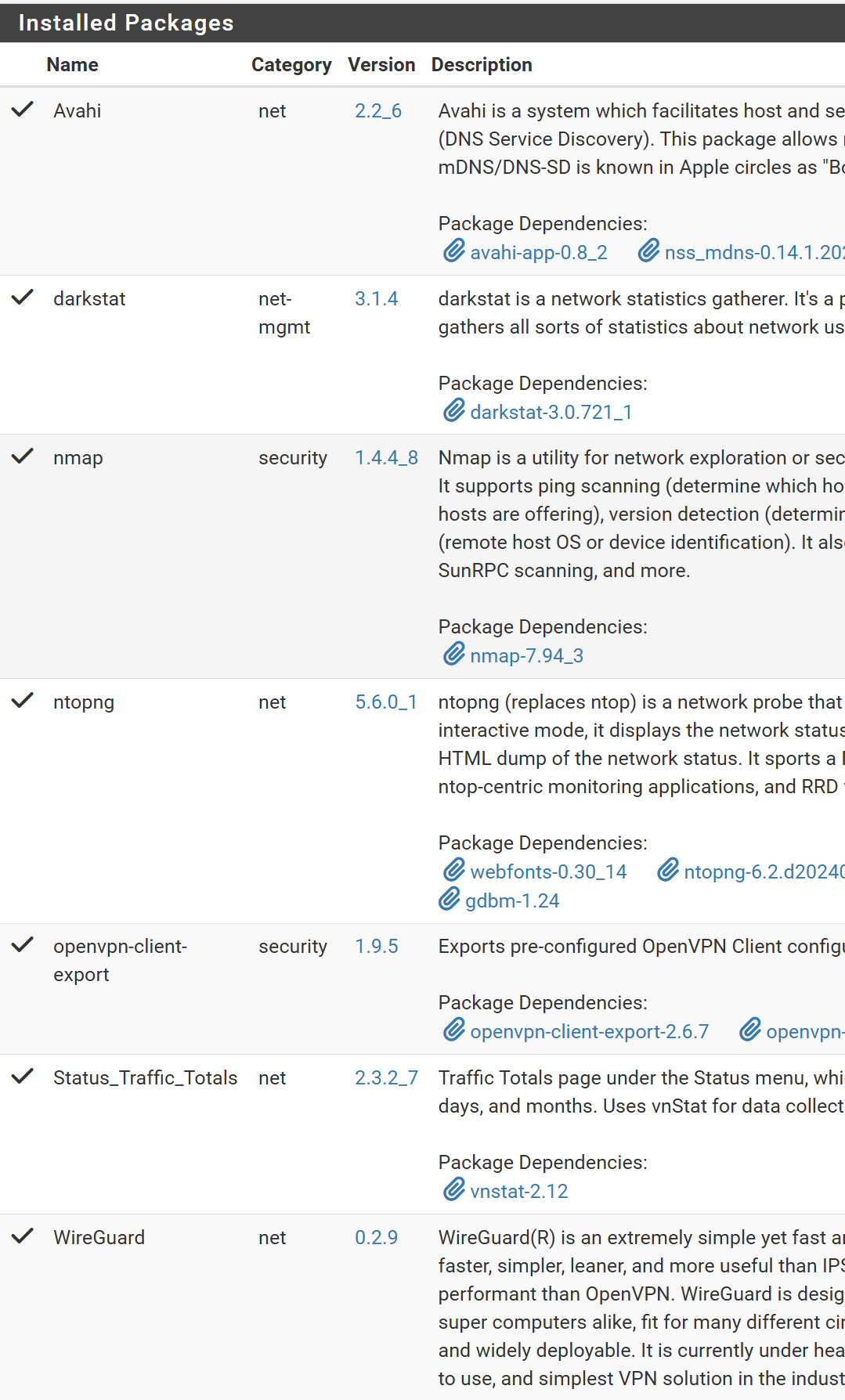

            I do not have pfblocker installed. These are the packages I have:

                  It looks like ntopng is my problem.

                  I just removed that package and disk usage seems better. Is there a utility I may need to run to clean up storage more?
                  Thanks again !
                  -Andy
                    Look inside /var/db/ntopng It probably still has the database file there. It should be safe to remove if the package has been uninstalled.
