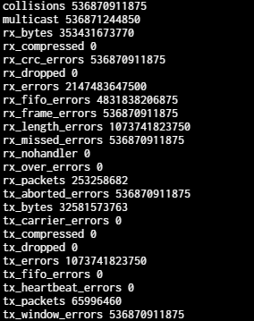

      Randomly all 4 ports on the NIC with start showing trillions of errors in netstat -i and i immediately lose access to the web ui but the console and machine are fine
      The large errors numbers are on all of the main links. If i swap that card for a known good I340-T4, it works flawlessly for weeks without a single error, but this specific card model seems to do it
      It is a genuine card from what i can tell with the intel logo on the PCB but both of the 350's are refurbished units from the same company

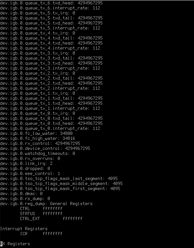

            Anything in the sysctl stats showing the error type?: sysctl dev.igb.0
            • B Offline
              bigjme93
              Annoyingly i had to restart the VM to try and check firmware versions but will wait for it to crash again and re-test, its likely to be later today but if not, i will grab the output and see what's going on
              Is there anything specific i should be looking for in that output?

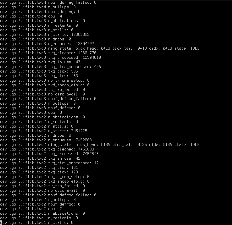

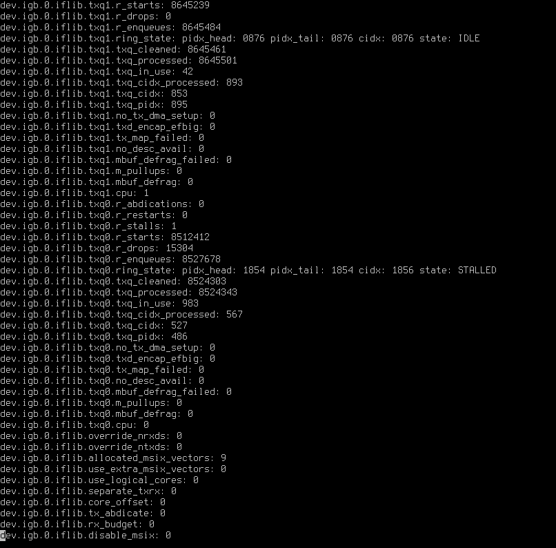

                There are a number of sysctls for different errors like:
                dev.igb.0.watchdog_timeouts: 0
                dev.igb.0.rx_overruns: 0
                dev.igb.0.dropped: 0
                dev.igb.0.mac_stats.coll_ext_errs: 0
                dev.igb.0.mac_stats.alignment_errs: 0
                dev.igb.0.mac_stats.crc_errs: 0
                dev.igb.0.mac_stats.recv_errs: 0
                dev.igb.0.mac_stats.recv_jabber: 0
                dev.igb.0.mac_stats.recv_oversize: 0
                dev.igb.0.mac_stats.recv_fragmented: 0
                dev.igb.0.mac_stats.recv_undersize: 0
                dev.igb.0.mac_stats.recv_no_buff: 0
                dev.igb.0.mac_stats.recv_length_errors: 0
                dev.igb.0.mac_stats.missed_packets: 0
                dev.igb.0.mac_stats.defer_count: 0

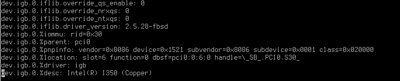

                    Hmm, hard to imagine a PXE firmware having any effect but....

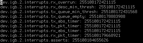

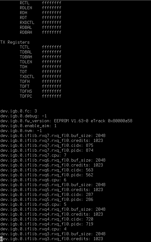

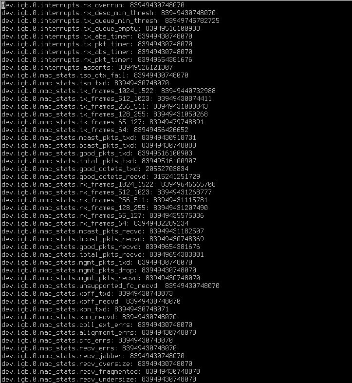

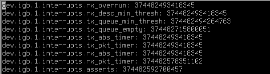

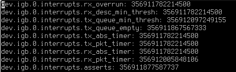

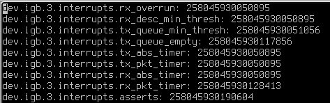

                        Ok so i thought it was going well but sadly it crashed last night, i have left the vm up in case i need to run further commands but because of this, i have no easy way to copy the command outputs so apologies in advance for the screenshots
                          Hmm, those values for interrupts and mac_stats look bogus. Like the driver or firmware are not returning real data or are returning bad data. That 'feels' like the firmware is failing.
                          Does it show bogus values for all 4 ports?
                          Does it show real data after a reboot? Does it require a full power cycle?
                          • B Offline
                            bigjme93
                            Yep, bogus values on all 4 ports and they all start at the exact same time as far as I can tell.
                            That makes me think its less likely to be a driver but I may be wrong.
                            Simply restarting the VM fixes the issues and it will go back to normal until it happens again.
                            To my knowledge, even a vm reboot does trigger the device to reset so it would make sense that this fixes it if it was firmware.
                            I have left the machine up with the nic broken just in case its worth me running some commands to see if anything can be ruled out.
                            For example, rebinding/resetting the igb driver etc. to see if it magically fixes without a device reset
                            Its not something that I am familiar with so I'm hoping for a little guidance from the experts here in hopes that the debugging may help someone else in a similar situation down the line.

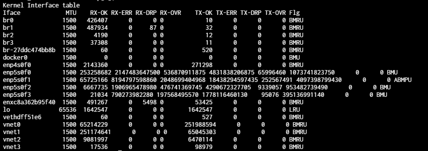

                                      Time for an update, sadly not a good one, i know this is getting a little off topic for pfSense directly but it may still help others
                                      Less than 48 hours and the same issues has happened on the host, spot the quad nic
                                      enp4s0f0 and f1 are my intel 10gb NICs but they use ixgbe. I tried reloading igb and had no luck

                                      [168717.401509] igb 0000:05:00.2 0000:05:00.2 (uninitialized): PCIe link lost
                                      [168717.402106] igb: Failed to read reg 0x18!
                                      [168717.402357] WARNING: CPU: 2 PID: 1106121 at drivers/net/ethernet/intel/igb/igb_main.c:745 igb_rd32+0x7c/0x90 [igb]
                                      [168717.402619] Modules linked in: igb(E+) vhost_net(E) tun(E) vhost(E) vhost_iotlb(E) macvtap(E) macvlan(E) tap(E) xt_nat(E) xt_tcpudp(E) veth(E) xt_conntrack(E) nft_chain_nat(E) xt_MASQUERADE(E) nf_nat(E) nf_conntrack_netlink(E) nf_conntrack(E) nf_defrag_ipv6(E) nf_defrag_ipv4(E) xfrm_user(E) xt_addrtype(E) nft_compat(E) nf_tables(E) libcrc32c(E) crc32c_generic(E) nfnetlink(E) br_netfilter(E) bridge(E) stp(E) llc(E) nvme_fabrics(E) overlay(E) sunrpc(E) binfmt_misc(E) ntb_netdev(E) ntb_transport(E) ntb_split(E) ntb(E) ioatdma(E) ib_core(E) edac_mce_amd(E) kvm_amd(E) kvm(E) irqbypass(E) ghash_clmulni_intel(E) sha512_ssse3(E) sha256_ssse3(E) sha1_ssse3(E) amdgpu(E) aesni_intel(E) crypto_simd(E) cryptd(E) snd_hda_codec_hdmi(E) rapl(E) drm_exec(E) amdxcp(E) drm_buddy(E) gpu_sched(E) drm_suballoc_helper(E) drm_display_helper(E) snd_hda_intel(E) cec(E) snd_usb_audio(E) snd_intel_dspcfg(E) snd_usbmidi_lib(E) rc_core(E) snd_hda_codec(E) snd_rawmidi(E) snd_seq_device(E) snd_hda_core(E) mc(E) snd_hwdep(E) drm_ttm_helper(E)
                                      [168717.402644]  snd_pcm(E) wmi_bmof(E) ttm(E) snd_timer(E) sp5100_tco(E) pcspkr(E) drm_kms_helper(E) snd(E) k10temp(E) watchdog(E) soundcore(E) ccp(E) cdc_mbim(E) joydev(E) cdc_wdm(E) sg(E) button(E) evdev(E) loop(E) drm(E) efi_pstore(E) configfs(E) ip_tables(E) x_tables(E) autofs4(E) zfs(POE) spl(OE) efivarfs(E) sr_mod(E) cdrom(E) hid_generic(E) cdc_ncm(E) cdc_ether(E) usbnet(E) usbhid(E) uas(E) hid(E) usb_storage(E) mii(E) sd_mod(E) ahci(E) nvme(E) ahciem(E) xhci_pci(E) libahci(E) xhci_hcd(E) ixgbe(E) nvme_core(E) libata(E) xfrm_algo(E) t10_pi(E) crc32_pclmul(E) mdio_devres(E) usbcore(E) scsi_mod(E) crc32c_intel(E) crc64_rocksoft(E) i2c_piix4(E) usb_common(E) scsi_common(E) crc64(E) crc_t10dif(E) i2c_algo_bit(E) libphy(E) dca(E) crct10dif_generic(E) mdio(E) crct10dif_pclmul(E) crct10dif_common(E) video(E) wmi(E) gpio_amdpt(E) gpio_generic(E) [last unloaded: igb(E)]
                                      [168717.405253] RIP: 0010:igb_rd32+0x7c/0x90 [igb]
                                      [168717.408900]  ? igb_rd32+0x7c/0x90 [igb]
                                      [168717.409393]  ? igb_rd32+0x7c/0x90 [igb]
                                      [168717.410845]  ? igb_rd32+0x7c/0x90 [igb]
                                      [168717.411088]  ? igb_rd32+0x7c/0x90 [igb]
                                      [168717.411330]  igb_get_invariants_82575+0xa6/0xf00 [igb]
                                      [168717.411577]  igb_probe+0x3be/0x1520 [igb]
                                      [168717.414240]  ? __pfx_igb_init_module+0x10/0x10 [igb]
                                      [168717.744687] igb 0000:05:00.2: PHY reset is blocked due to SOL/IDER session.
                                      [168719.474678] igb 0000:05:00.2: The NVM Checksum Is Not Valid
                                      [168719.664847] igb: probe of 0000:05:00.2 failed with error -5
                                      [168719.665336] igb 0000:05:00.3: enabling device (0000 -> 0002)
                                      [168719.665475] igb 0000:05:00.3 0000:05:00.3 (uninitialized): PCIe link lost
                                      [168719.666111] igb: Failed to read reg 0x18!
                                      [168719.666361] WARNING: CPU: 10 PID: 1106121 at drivers/net/ethernet/intel/igb/igb_main.c:745 igb_rd32+0x7c/0x90 [igb]
                                      [168719.666623] Modules linked in: igb(E+) vhost_net(E) tun(E) vhost(E) vhost_iotlb(E) macvtap(E) macvlan(E) tap(E) xt_nat(E) xt_tcpudp(E) veth(E) xt_conntrack(E) nft_chain_nat(E) xt_MASQUERADE(E) nf_nat(E) nf_conntrack_netlink(E) nf_conntrack(E) nf_defrag_ipv6(E) nf_defrag_ipv4(E) xfrm_user(E) xt_addrtype(E) nft_compat(E) nf_tables(E) libcrc32c(E) crc32c_generic(E) nfnetlink(E) br_netfilter(E) bridge(E) stp(E) llc(E) nvme_fabrics(E) overlay(E) sunrpc(E) binfmt_misc(E) ntb_netdev(E) ntb_transport(E) ntb_split(E) ntb(E) ioatdma(E) ib_core(E) edac_mce_amd(E) kvm_amd(E) kvm(E) irqbypass(E) ghash_clmulni_intel(E) sha512_ssse3(E) sha256_ssse3(E) sha1_ssse3(E) amdgpu(E) aesni_intel(E) crypto_simd(E) cryptd(E) snd_hda_codec_hdmi(E) rapl(E) drm_exec(E) amdxcp(E) drm_buddy(E) gpu_sched(E) drm_suballoc_helper(E) drm_display_helper(E) snd_hda_intel(E) cec(E) snd_usb_audio(E) snd_intel_dspcfg(E) snd_usbmidi_lib(E) rc_core(E) snd_hda_codec(E) snd_rawmidi(E) snd_seq_device(E) snd_hda_core(E) mc(E) snd_hwdep(E) drm_ttm_helper(E)
                                      [168719.666648]  snd_pcm(E) wmi_bmof(E) ttm(E) snd_timer(E) sp5100_tco(E) pcspkr(E) drm_kms_helper(E) snd(E) k10temp(E) watchdog(E) soundcore(E) ccp(E) cdc_mbim(E) joydev(E) cdc_wdm(E) sg(E) button(E) evdev(E) loop(E) drm(E) efi_pstore(E) configfs(E) ip_tables(E) x_tables(E) autofs4(E) zfs(POE) spl(OE) efivarfs(E) sr_mod(E) cdrom(E) hid_generic(E) cdc_ncm(E) cdc_ether(E) usbnet(E) usbhid(E) uas(E) hid(E) usb_storage(E) mii(E) sd_mod(E) ahci(E) nvme(E) ahciem(E) xhci_pci(E) libahci(E) xhci_hcd(E) ixgbe(E) nvme_core(E) libata(E) xfrm_algo(E) t10_pi(E) crc32_pclmul(E) mdio_devres(E) usbcore(E) scsi_mod(E) crc32c_intel(E) crc64_rocksoft(E) i2c_piix4(E) usb_common(E) scsi_common(E) crc64(E) crc_t10dif(E) i2c_algo_bit(E) libphy(E) dca(E) crct10dif_generic(E) mdio(E) crct10dif_pclmul(E) crct10dif_common(E) video(E) wmi(E) gpio_amdpt(E) gpio_generic(E) [last unloaded: igb(E)]
                                      [168719.669264] RIP: 0010:igb_rd32+0x7c/0x90 [igb]
                                      [168719.672935]  ? igb_rd32+0x7c/0x90 [igb]
                                      [168719.673429]  ? igb_rd32+0x7c/0x90 [igb]
                                      [168719.674884]  ? igb_rd32+0x7c/0x90 [igb]
                                      [168719.675127]  ? igb_rd32+0x7c/0x90 [igb]
                                      [168719.675369]  igb_get_invariants_82575+0xa6/0xf00 [igb]
                                      [168719.675616]  igb_probe+0x3be/0x1520 [igb]
                                      [168719.678284]  ? __pfx_igb_init_module+0x10/0x10 [igb]
                                      [168720.008929] igb 0000:05:00.3: PHY reset is blocked due to SOL/IDER session.
                                      [168721.738903] igb 0000:05:00.3: The NVM Checksum Is Not Valid
                                      [168721.916849] igb: probe of 0000:05:00.3 failed with error -5
                                      My last port of call now is to pull the nic and try it in a difference PCI-e slot
                                      The current slot is a gen 3 1x slot so should be fine but i will try it in a gen 5 16x on the same system just in case its causing issues. I doubt it but it is indeed looking like some kind of hardware issue now
                                      Regards,
                                      Jamie
                                      • B Offline
                                        bigjme93
                                        For anyone interested in the exciting conclusions... it worked fine in the 16x slot for 2 weeks and is still in there now
                                        I put an I340-T4 in the 1x slot at the same time and left that running and that has been perfectly fine as well
                                        It seems to be an incompatibility between the 1x slot and the I350 specifically but i'm not sure why. In either case, the issue seems to be resolved
                                        It may be something specific to AM5 and the I350 in the 1x, or just the I350 and the 1x alone but if anyone else for some reason tries the same, at least you know what symptoms manifest and what the cause was
                                        Thanks again for those that helped and commented
