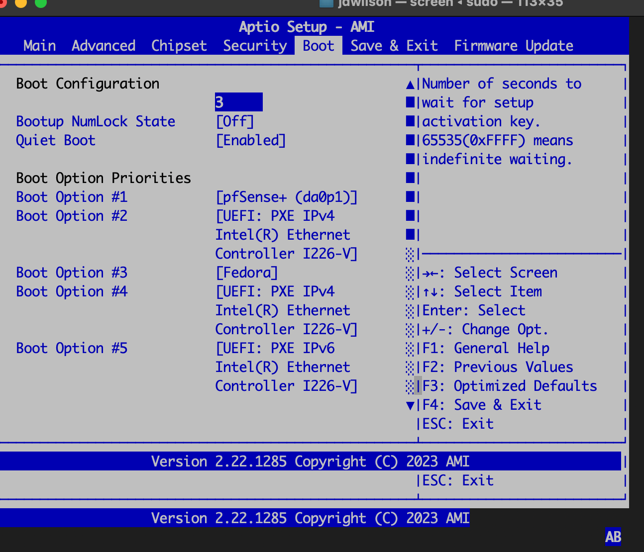

      So to summarize, I have reviewed the referenced topic above as well as https://forum.netgate.com/topic/196289/netgate-4200-boot-problems/18
      The short explanation is that my 4200 will not boot into pfSense+. I have connected to it via console, reviewed the boot order, which shows pfSense as first priority. I am running the current v24.11, but w/o any patches at this time.
      If you allow the boot process to continue past the break for the bios menu, I get this on the console:

        @jdstlnet
        According the BIOS, the boot order seems fine : the first partition called pfSense (on da0p1) is most probably your pfSense 24.11.
        What happens when you boot into that partition ?

          jdstlnet @jdstlnet
          @jdstlnet I have additional information on this issue. I was finally able to log the serial console output. Note that the prompt to escape to the BIOS menu may not show up, however, I found it in the log and when the screen clears, you can hit ESC about 1 per second to get into BIOS menu. It's intermittent if the prompt to escape into the BIOS menu shows up.
          Checking Media Presence......
          No Media Present......ERROR: Boot option loading failed
          So, again, the BIOS menu looks correct and the boot order, #1 is the pfSense partition as previously shown.
          What I have not found yet is if there is a way to force the partition to boot from the EFI shell prompt to see if it fails from that approach.
          Also, to @Gertjan's reply, it does not boot (at least to pfSense), it just falls out to the EFI shell as show previously. What I don't understand is how this new model can have an issue with default hardware configuration. Per the 4200 spec, 128GB NVMe SSD and 4GB LP DDR5 memory. I understand about MTD wear leveling, but not this soon.
          Would appreciate if someone can point me in the right direction here to get this resolved. Will also see if I can submit a ticket to Netgate. The appliance was bought new when they came out in Jan 2023.

              Does it boot from USB if you insert a drive with the installer on it?
              That looks like it's unable to from eMMC and eventually fails through to the EFI shell as the only bootable option.
