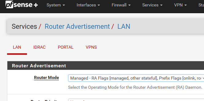

      The Router Advertisements needs a small change. Before I had always left this all blank in the photo below thinking it was automatically provided by the DHCPv6 when set to Managed. I was wrong dead wrong with this.

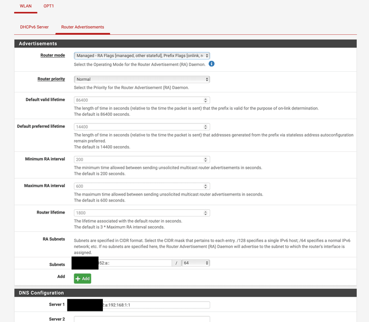

      You must include the ipv6 lan Subnet inside Router Advertisements section of config as well as the DNS server 1 should be the interface's ipv6 address it self, also set Setting check Use same settings as DHCPv6
      The areas marked with the censored is the area you must fill in.

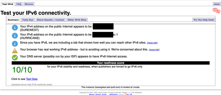

      Bingo 10/10 every time on the test. Without this it would send out a FE ip6 address to clients and cause issues where the web browsers would not use the ipv6 unless forced to like with ipv6.google.com as an example it worked before but this change makes it work smoothly.

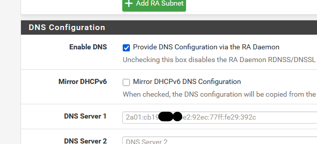

        Router advertisement has it own menu now ( ! ) :
        What pfSense version ?
        Is 2.8.0 different here ?
        Is already there by default, mine is shown in 'gray' so picked by pfSense. I have :

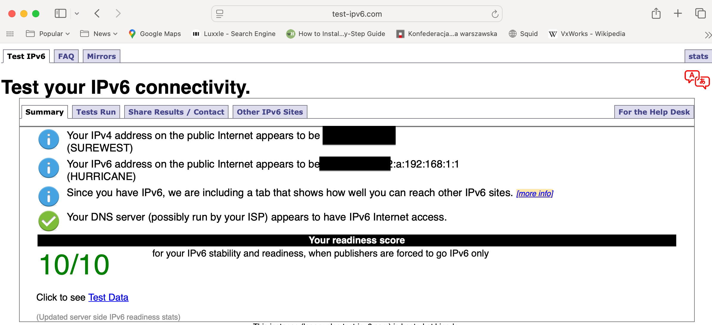

            @Gertjan Fixed it. I had on the interface address both an IPv6 address and an "IPv4 address embedded in the IPv6 address (this is known as IPv6-mapped IPv4 addresses or IPv6 embedded IPv4 addresses)" before that is normally not for interfaces only the static device assignments so that is corrected my Pv6-mapped IPv4 addresses or IPv6 embedded IPv4 addresses are now only on the Lan devices and not on the firewall interfaces.
