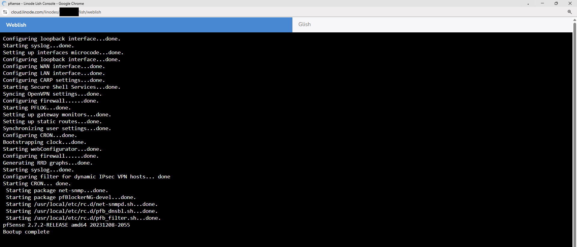

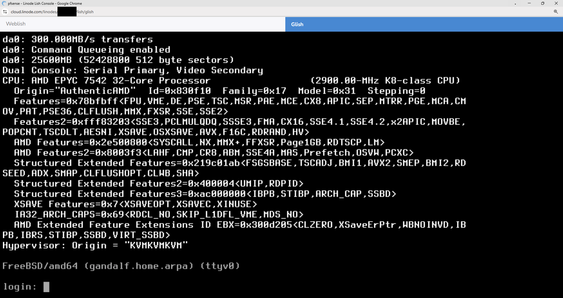

      I installed pfSense on a Linode VM and I need to access it via a web browser interface Linode supply (all other network access options are not valid now, this is why only console is possible for me), which has two options one called Weblish which is responsive but I don't see there the auth cli prompt to use for login, it only shows at the end - "Bootup complete", and the other is Glish, which does show the login prompt, but it is VERY buggy and unresponsive (it shows it use ttv0).
      I wish to be able to see the login cli prompt a Weblish, I can have access to the disk filesystem, mounted using a temp FreeBSD VM - do I need to edit the /etc/tty file? if so - what should I put there?

          I am able to see and interact with the TUI console at Weblish, but the issue is that it only shows the boot output, it not ends not in the pfSense console menu and not in a FreeBSD login prompt
          The Glish is also TUI and shows an OS login but it is not responsive nor steady so I cannot enter the password. see attached screen shots

            It is running dual console though and with serial as primary. So it looks like the Glish console is serial and the console is password protected.
