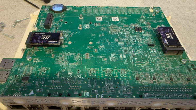

            Hello, could you please provide link for SSD to purchase. King spec seems to be 2242 and I believe we need 2280 b+m key. Which I’m not able to find anywhere. Appreciate if someone can post the links to purchase the ssd. I have 6100. I’m afraid it can fail anytime and it’s not max. Not sure which SSD WORKS.

              @supriya 2242 will fit in a 6100. That's what I have myself. I just bought another one today to use in a 4100 with a dead eMMC...
              https://www.amazon.com/KingSpec-256GB-Performance-Internal-Ultrabook/dp/B08TTDQ5WH/

                  @supriya I can also confirm that the 2242 that @luckman212 linked to, is the same one I've been using since this post, no problems at all so far.

                    @tariqali thank you for the confirmation. Did you guys used heat sinks ? Or it is fine without it?

                      @supriya I didn't use a heatsink, and don't believe one is needed for this part.

                        @supriya It actually comes with a thin heatsink stickied on one side, I think it's copper.
                        I actually peeled it off initially because I was going to add a heatsink and realized that what the sticker was.
