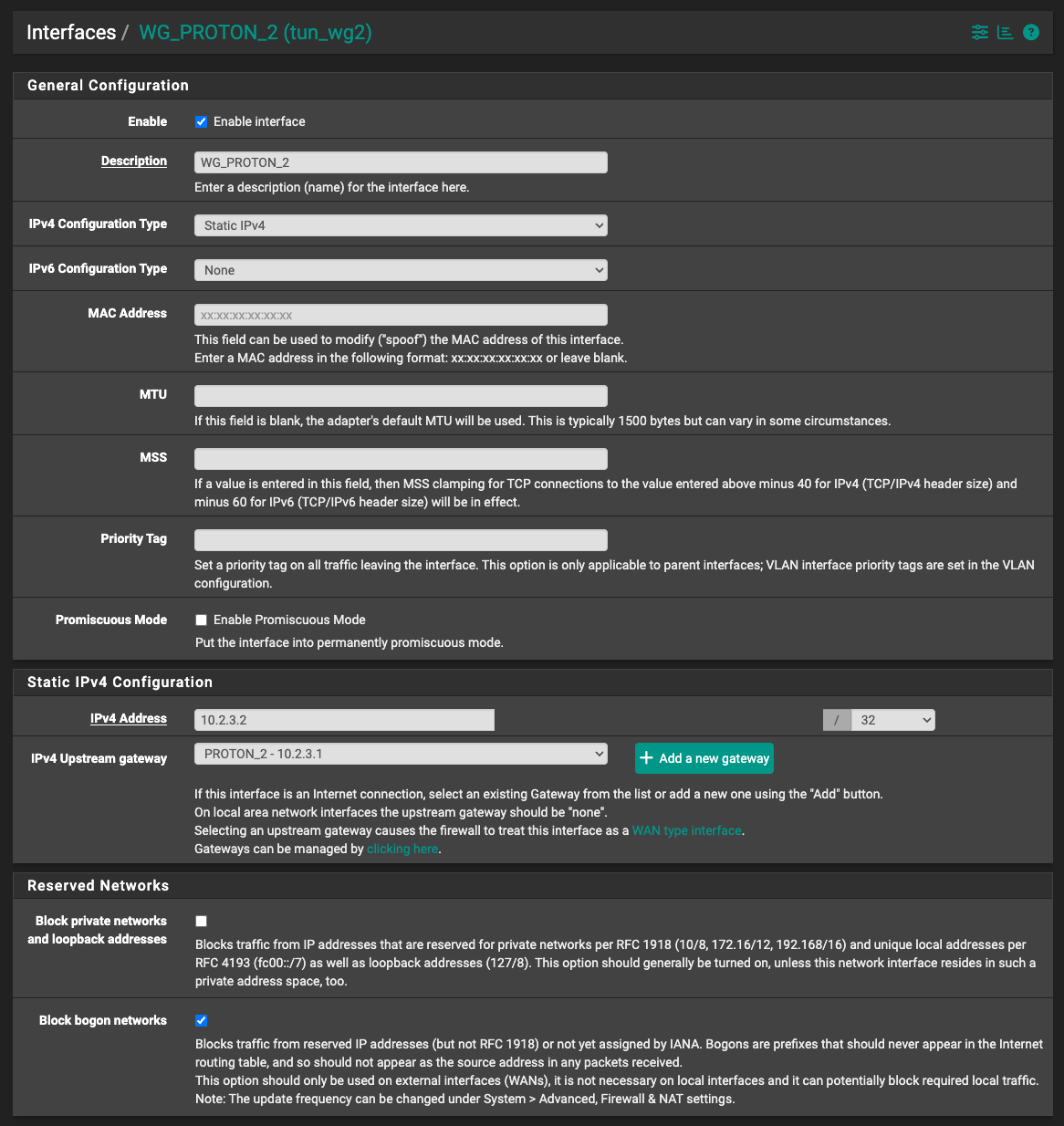

      • each WG tunnel is connected to an interface, connected to a gateway (I can't see any interfaces in your post)

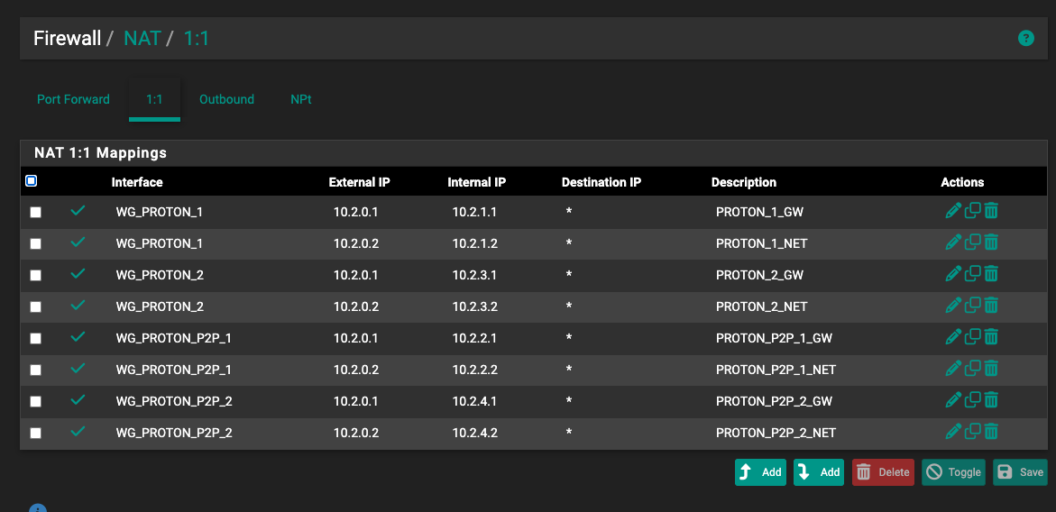

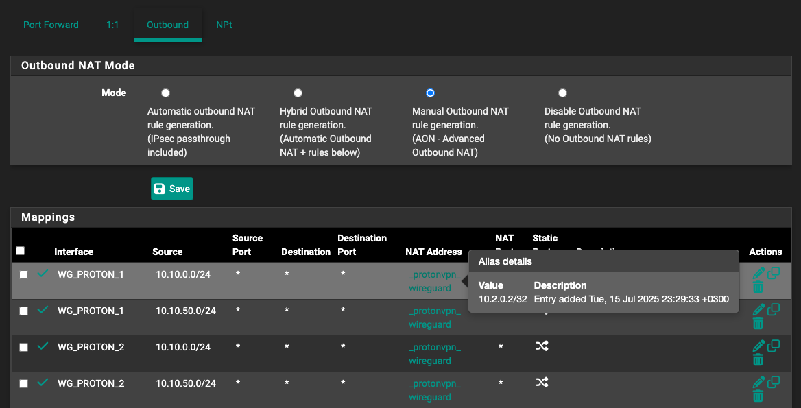

        • I only use outgoing NAT, no 1:1 NAT
          You are probably using a VPN provider that gives you different IPs
          I am using ProtonVPN. ProtonVPN attempts to preserve privacy by using a single IP address 10.2.0.2 when you connect using Wireguard. The routing table rejects adding route collisions for multiple Wireguard connections all using 10.2.0.2/32 pointing to multiple different interfaces. Hence I can not use the "normal way" to add multiple Wireguard

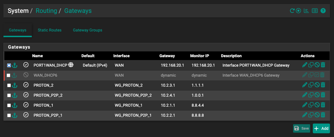

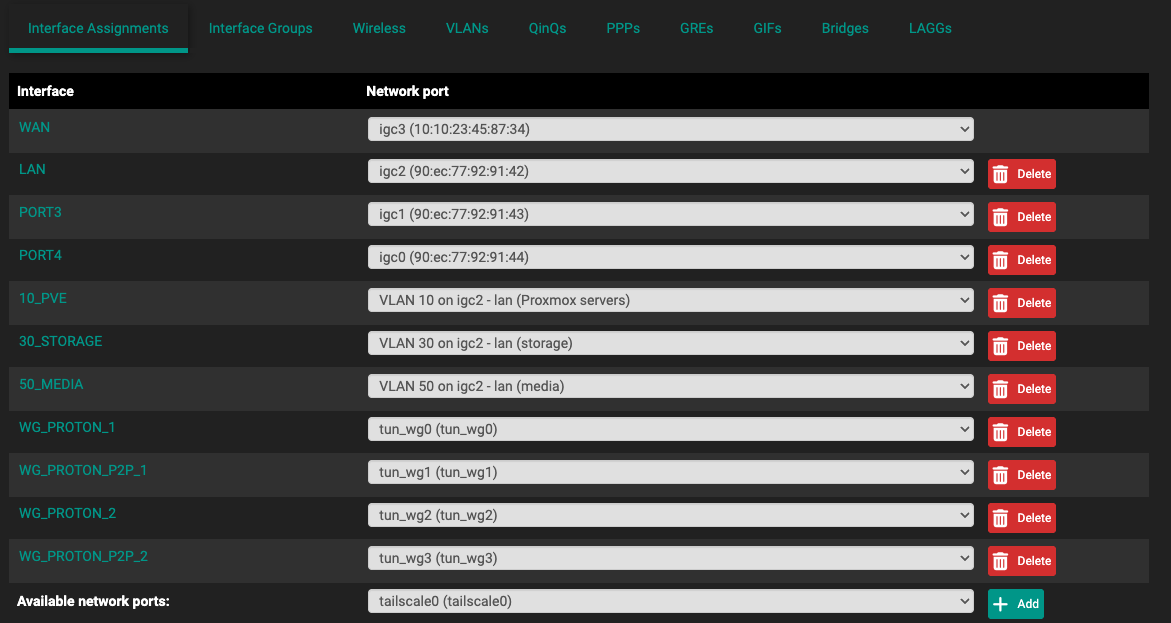

          yes I did not post the whole configurations as I thought it is irrelevant to the problem. Here are the interfaces
        Sample Interface conf
        As I said you are probably using a VPN provider that has different IPv4 address that you can assign to the Interface. ProtonVPN uses 10.2.0.2/32 all the time for privacy reason and that is why I am using the 1:1 NAT trick. [more here]
        As you can see it is not the 'usual setup'.
        Everything is working fine up until I reboot the Netgate.
        Rebooting somehow breaks the NAT 1:1 on the way out. Simply adding a dummy Wireguard Tunnel makes everything work again.

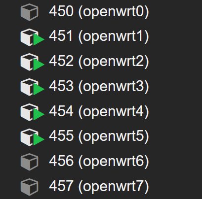

                      You are right, I must have confused this with another VPN-Provider. I am using OpenWRT-VMs for all my Proton-WG-tunnels.
