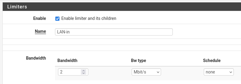

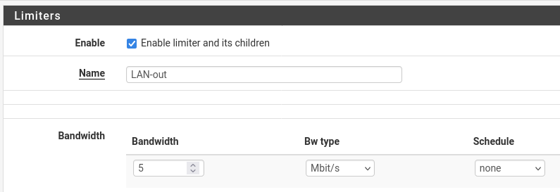

              • N Offline
                NWOSwamp @stephenw10
                I have a nearly step-by-step, from a fresh install, how I duplicated the issue in my original post. I wiped out my lab, I recreated from that post (hopefully accurately). The testing & results should be pretty close. LMK if you're looking for something different.
                2.7.2
                Rules:
                # User-defined rules follow
                anchor "userrules/*"
                pass  out  quick  on {  vtnet0  }  $GWWAN_DHCP inet from <WAN IP> to any ridentifier 1752945005 keep state  dnqueue( 1,2) label "USER_RULE: Bufferbloat" label "id:1752945005" label "gw:WAN_DHCP"
                pass  in  quick  on $LAN inet from $LAN__NETWORK to any ridentifier 0100000101 keep state  dnpipe ( 3,4) label "USER_RULE: Default allow LAN to any rule" label "id:0100000101"
                Limiter Info:
                Limiters:
                00001:  20.000 Mbit/s    0 ms burst 0
                q131073  50 sl. 0 flows (1 buckets) sched 65537 weight 0 lmax 0 pri 0  AQM CoDel target 1us interval 1us ECN
                 sched 65537 type FIFO flags 0x0 0 buckets 0 active
                00002: 100.000 Mbit/s    0 ms burst 0
                q131074  50 sl. 0 flows (1 buckets) sched 65538 weight 0 lmax 0 pri 0  AQM CoDel target 1us interval 1us ECN
                 sched 65538 type FIFO flags 0x0 0 buckets 0 active
                00003:   2.000 Mbit/s    0 ms burst 0
                q131075  50 sl. 0 flows (1 buckets) sched 65539 weight 0 lmax 0 pri 0 droptail
                 sched 65539 type FIFO flags 0x0 0 buckets 0 active
                00004:   5.000 Mbit/s    0 ms burst 0
                q131076  50 sl. 0 flows (1 buckets) sched 65540 weight 0 lmax 0 pri 0 droptail
                 sched 65540 type FIFO flags 0x0 0 buckets 0 active
                Schedulers:
                q65537  50 sl. 0 flows (1 buckets) sched 1 weight 0 lmax 0 pri 0 droptail
                 sched 1 type FQ_CODEL flags 0x0 0 buckets 0 active
                 FQ_CODEL target 1us interval 1us quantum 1514 limit 10240 flows 1024 ECN
                   Children flowsets: 1
                q65538  50 sl. 0 flows (1 buckets) sched 2 weight 0 lmax 0 pri 0 droptail
                 sched 2 type FQ_CODEL flags 0x0 0 buckets 0 active
                   Children flowsets: 2
                q65539  50 sl. 0 flows (1 buckets) sched 3 weight 0 lmax 0 pri 0 droptail
                 sched 3 type FIFO flags 0x0 0 buckets 0 active
                q65540  50 sl. 0 flows (1 buckets) sched 4 weight 0 lmax 0 pri 0 droptail
                 sched 4 type FIFO flags 0x0 0 buckets 0 active
                Queues:
                q00001  50 sl. 0 flows (1 buckets) sched 1 weight 0 lmax 0 pri 0  AQM CoDel target 1us interval 1us ECN
                q00002  50 sl. 0 flows (1 buckets) sched 2 weight 0 lmax 0 pri 0  AQM CoDel target 1us interval 1us ECN
                Interpreted Rules:
                @84 anchor "userrules/*" all
                  [ Evaluations: 73        Packets: 0         Bytes: 0           States: 0     ]
                  [ Inserted: uid 0 pid 9606 State Creations: 0     ]
                  [ Last Active Time: N/A ]
                @85 pass out quick on vtnet0 route-to (vtnet0 <WAN Gateway>) inet from <WAN IP> to any flags S/SA keep state label "USER_RULE: Bufferbloat" label "id:1752945005" label "gw:WAN_DHCP" ridentifier 1752945005 dnqueue(1, 2)
                  [ Evaluations: 73        Packets: 14677     Bytes: 15410930    States: 20    ]

                • stephenw10S Online
                  The major difference there is the state binding. Note they are bound to all in 2.7.2 but interface bound in 2.8.0.
                  Did you try reverting that change in 2.8.0 to see if that makes any difference?
                  The other thing is that I expect to see the limiters in the reverse order on the outbound rule but it could be you're just testing that way? That might explain one of the test failures you saw above.
                  Also that's the non-policy routing situation?
                    If I understand this, the labeling of my limiter matches the GUI. GUI option is labeled In / Out Pipe so I have the first one labeled WAN-in-q & LAN-in, the second WAN-out-q & LAN-out. I verified bandwidths amounts set in the limiters and the order in the rules are correct and consistent between the two versions.
