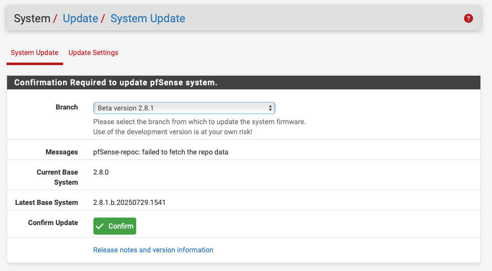

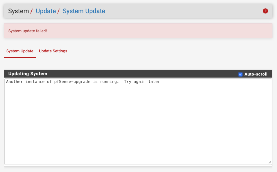

                          @stephenw10 Pretty much the same things described here, but trying to go from 2.8.0 to the 2.8.1 beta.
                          Upgrading from the console:
                          Enter an option: 13
                          pfSense-repoc-static: failed to fetch the repo data
                          failed to read the repo data.
                          failed to update the repository settings!!!
                          pfSense - Netgate Device ID: xyzblahblah
                          From the webUI:
                          Tried the fixes described in this thread and that one "Another instance of pfSense-upgrade is running. Try again later"
                          No change. Now while I can do w/o the beta, it seems something’s messed up, and that something will come to bite me once 2.8.1 is out of beta, so just shrugging the shoulders is just kicking the can down the road...

                              So far so good, but unfortunately, the trouble still isn’t over.
                              Going to the System > Update section in the WebUI, I still get:
                              pfSense-repoc: failed to fetch the repo data
                              and trying to install some package, I still, after hitting the green "confirm" button, get:
                              <package> installation failed!
                              So close, yet….

                                        This very specific scenario has persisted for quite some time, and I’m sure it will eventually turn out to be something tiny, the question is just: what could cause these symptoms?
                                        Had this very issue before, and now after, force upgrading to 2.8.1 (following the upgrading troubleshooting guide in the documentation), and I have it on two systems configured in a similar fashion (they are the end points of the same tunnel)
                                        While it doesn’t interfere with regular operations, it makes upgrades/updates quite some hassle. And of course it’s bugging me, that something is off.
                                          Hmm, what sort of tunnel? Is it somehow trying to pass the upgrade traffic across it?
