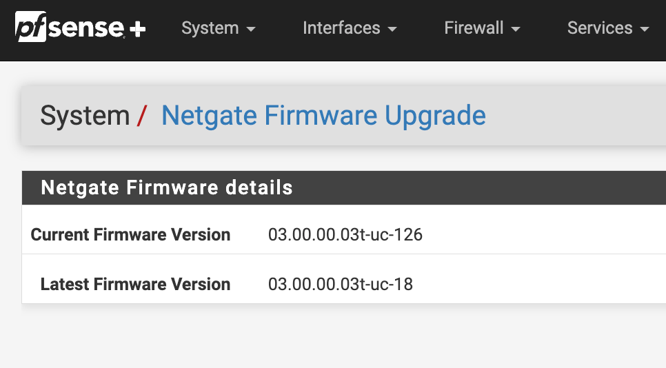

      Updated my 6100 to 25.07 RC today, and just clicking around I noticed a new Firmware seems to have been installed: 03.00.00.03t-uc-126
      Is this expected? I note the "latest" version appears to be an older build (uc-18):

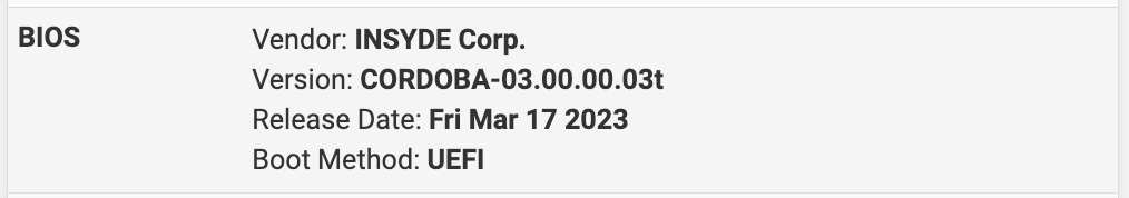

      Also, on my Dashboard, it shows BIOS CORDOBA-03.00.00.03t - with a date of 2023-03-17 - do these BIOS and Firmware versions align?

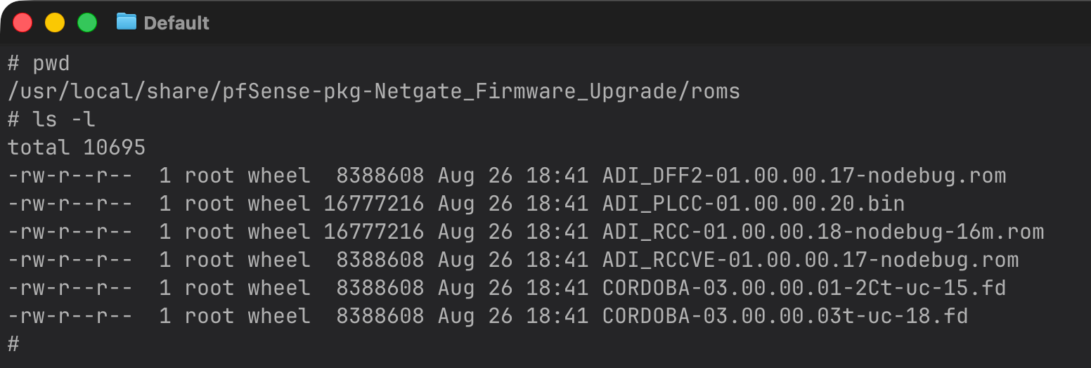

        Hmm, nope. 18 is the latest microcontroller code version.
        [25.07-RC] [admin@6100.stevew.lan]/root: ls -ls /usr/local/share/pfSense-pkg-Netgate_Firmware_Upgrade/roms/
        total 10695
         817 -rw-r--r--  1 root wheel  8388608 Nov 12  2024 ADI_DFF2-01.00.00.17-nodebug.rom
        3257 -rw-r--r--  1 root wheel 16777216 Nov 12  2024 ADI_PLCC-01.00.00.20.bin
        1073 -rw-r--r--  1 root wheel 16777216 Nov 12  2024 ADI_RCC-01.00.00.18-nodebug-16m.rom
         817 -rw-r--r--  1 root wheel  8388608 Nov 12  2024 ADI_RCCVE-01.00.00.17-nodebug.rom
        2361 -rw-r--r--  1 root wheel  8388608 Nov 12  2024 CORDOBA-03.00.00.01-2Ct-uc-15.fd
        2373 -rw-r--r--  1 root wheel  8388608 Nov 12  2024 CORDOBA-03.00.00.03t-uc-18.fd
        [25.07-RC][admin@6100.stevew.lan]/root: sysctl dev.cordbuc.0.version
        dev.cordbuc.0.version: 18

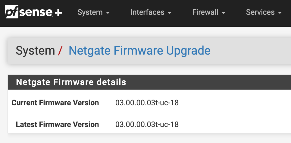

        Try a full power cycle if you haven't already.
        luckman212L 1 Reply Last reply Reply Quote 1
        • luckman212L Offline
          luckman212 LAYER 8 @stephenw10
          Thanks Steve, the full power cycle / cold boot got things sorted:

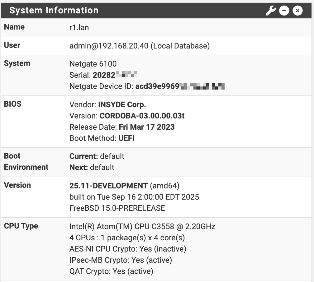

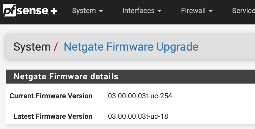

              @stephenw10 Updated to 25.11.a.20250916.0600 yesterday and noticed this came up again (little different this time, now it says 03.00.00.03t-uc-254)
              Cold boot fixed it again. Strange.
                Hmm, if you see it again check the version reported in the sysctl:
                [25.07.1-RELEASE][admin@6100.stevew.lan]/root: sysctl dev.cordbuc.0.version
                luckman212L 1 Reply Last reply Reply Quote 0
                  @stephenw10 Yeah, damn, I had that in my notes from the last time, but I forgot. I'll try to remember next time!
                    It pretty much has to be reporting incorrectly there since that's what the gui uses but it would be good to confirm.
