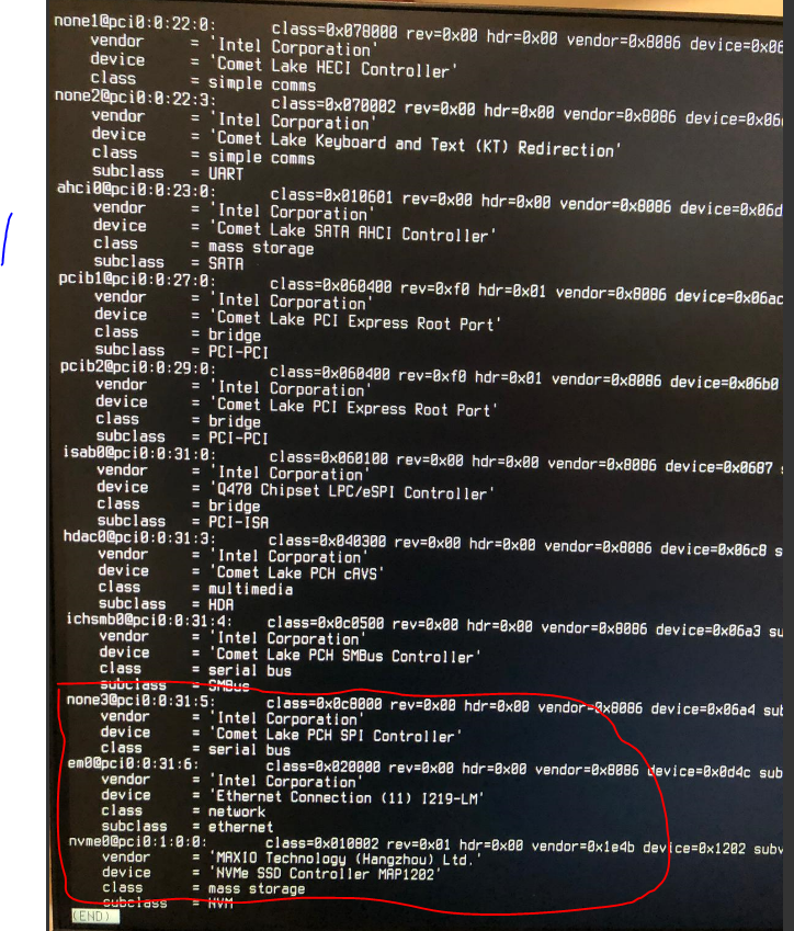

                johnytb @patient0
                @patient0
                as you can see the pfsense cant detect the second intel NIC 225v
                • patient0P Online
                  patient0 @johnytb
                  @johnytb the internet returns for HP 8719, HP ProDesk 400 G7 SFF.
                  Maybe the PCI slot on the motherboard is disabled? Do you have any other PC/motherboard where you can verify the Gtek card?
                  Btw: do you have an link to the Gtek, where you bought it? I only find 10GTek.
