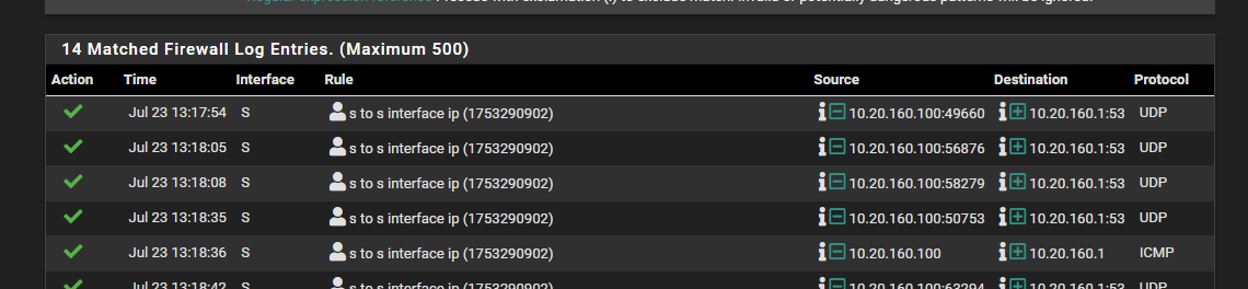

                @greatbush on your sniff - what is the mac address - have no idea why you searched for 10.20.x.x as a src IP?

                    @johnpoz the mac address is 98:fc:84:d1:db:44.
                    I used the filer 'eth.addr == 98:fc:84:d1:db:44' and searched the other pcap files but the only thing that shows up is the echo ping request.
                    For some reason its not reach the 172.16.64.1 interface.

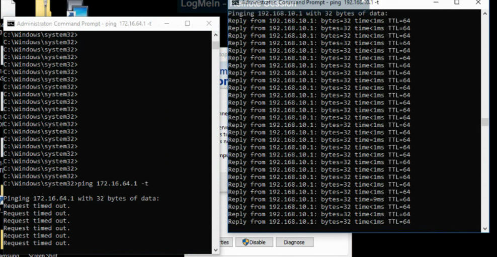

                              that is pinging the server at .200 - ping pfsense IP on the server network 172.16.64.1 I believe is what you have posted.
                              There is a huge difference between not getting an answer from server, and not being able to ping pfsense IP on that network.
                              All kinds of other issues could be going on to why that server doesn't answer - but pfsense no answering when you ping one of its IPs and your firewall rules allow it, and traffic gets to pfsense is something going on in pfsense.

                                @johnpoz i have tried pinging both .200 and .64.1 and i got the exact same result despite me adding rules for both on the S interface. Pfsense isn't dying, right?

                                        @greatbush but that test PC that is different IP 160.100 can not ping the server IP of 64.1 ?

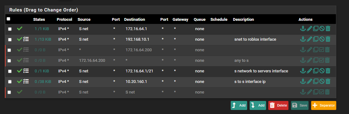

                                        You changed the rules to any S subnet to Server subnet I believe. So yeah you should be able to ping the pfsense server interface IP.
                                        Can we see the full ruleset on the S interface of pfsense.

                                          @johnpoz
                                          Its just having trouble connecting to the 172 network
