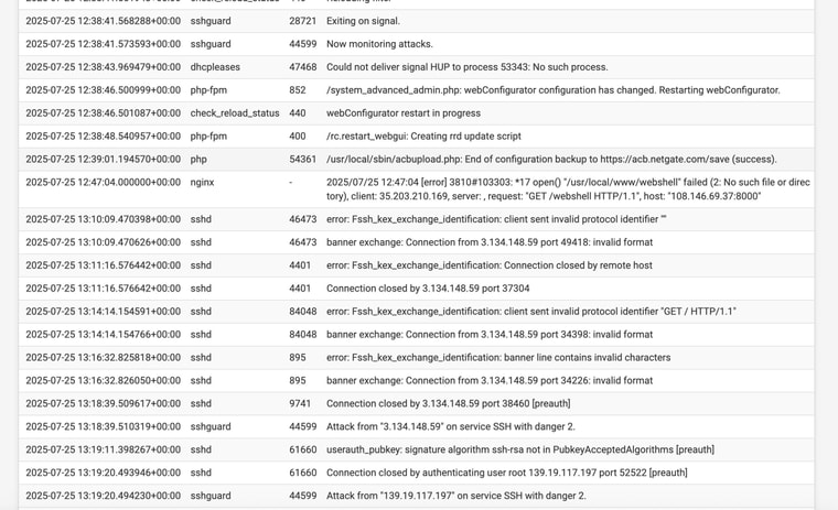

      I just setup a new router from a backup of my old device -- I was looking at logs to be sure things were running smoothly.
      I admitedly dont look often enough!
      I saw all these SSH attacks. (One I'm not sure is even depicted here was "level 10"
      The only thing I did was change SSH access to require password and key (from password alone).
      After that I still see attacks (see attached)
      Suggestions? Is. this a problem!

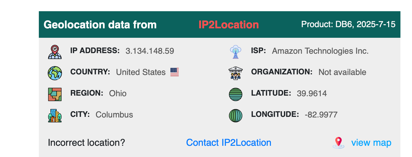

        do you have ssh port 22 open on your WAN?
        looks like IP address is owned by amazon

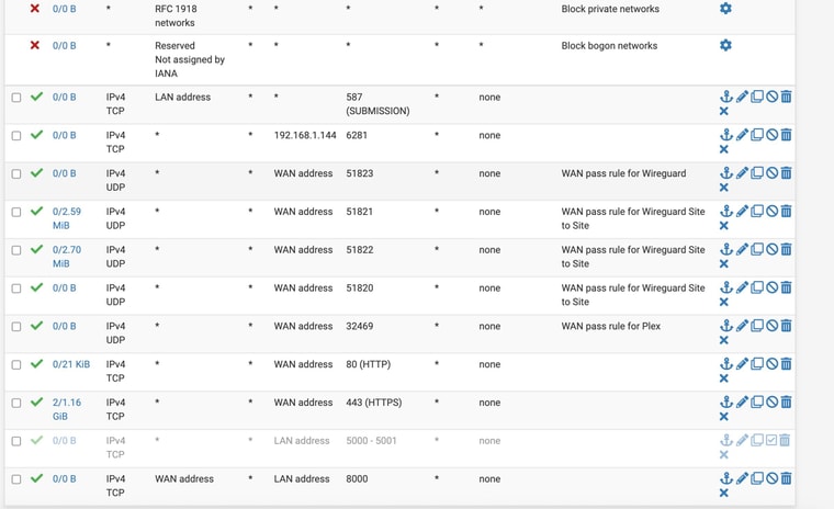

          S johnpozJ 2 Replies Last reply Reply Quote 0
            SteveITS Galactic Empire @ahole4sure
            @ahole4sure FWIW the rule for port 587 won't trigger there because a packet from LAN doesn't arrive on WAN.
            Do you have any NAT rules defined?

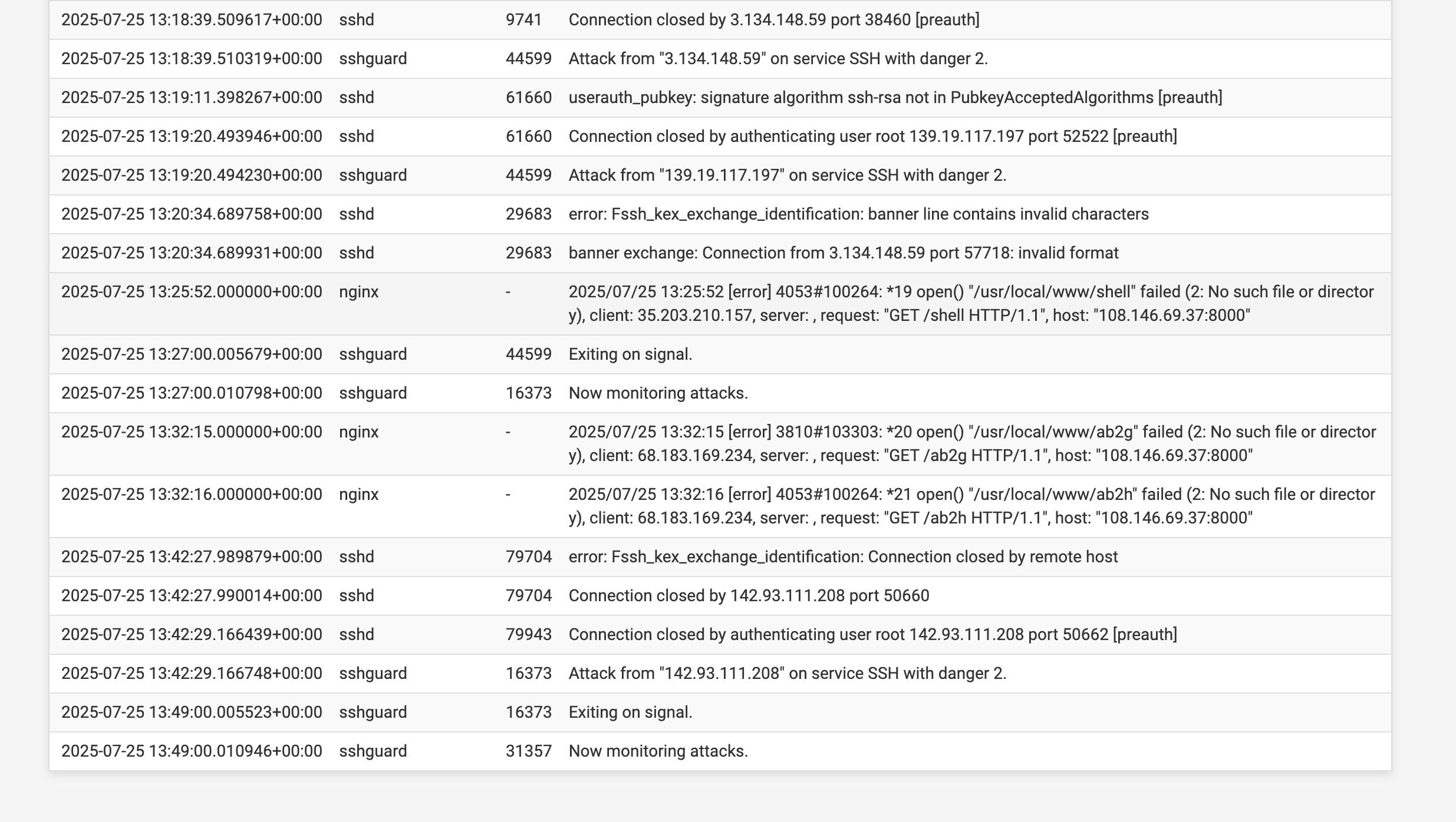

            FWIW the "exiting"/"now monitoring attacks" messages are logged when sshguard restarts due to a log file rollover so ignore those.

              johnpoz LAYER 8 Global Moderator @ahole4sure
              @ahole4sure do you have any floating rules? Is ssh running on standard port 22?

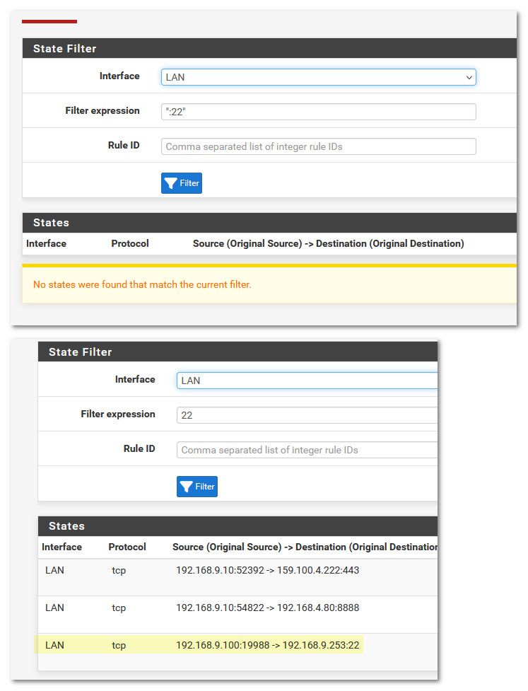

                      Not sure if I did correctly or not but I went to
                      Diagnostics > States
                      And filter expression - “:22”
                      I got no states actually for :22
                      There were several results but they were like this as an example. But not really port 22
                      108.146.69.37:22582 -> 8.8.8.8:53
                        @ahole4sure said in SSH "attacks":
                        that wouldn't be right - in the states just use 22
                        if you to see something there needs to be an active state.. So if someone tried to hit your ssh like 20 minutes ago, that state would be gone.. If you are hits often enough just keep checking.

                            Yup you would only see states while they're still active. So if you are not seeing attacks that often you'd have to get lucky to catch it.
                            But you should see those by filtering for: 22

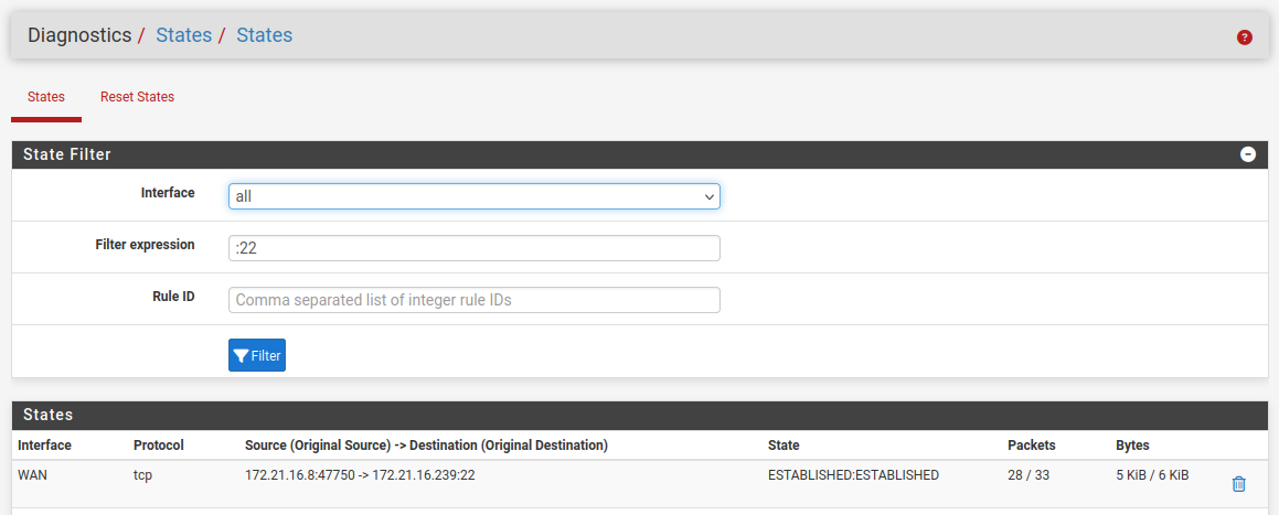

                            What rules do you have on the VPN interface(s)? It would be unusual to see connections being forwarded to you there though.
