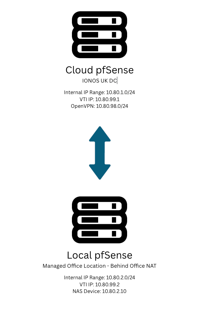

      The network running 2.8.0 on both sites and they have the following config:
      Site 1 - Remote Site (IONOS)
      Internal IP Range: 10.80.1.0/24
      IPsec VTI: 10.80.99.1
      OpenVPN: 10.80.98.0/24
      Site 2 - Local Site (Managed Office)
      Internal IP Range: 10.80.2.0/24
      IPsec VTI: 10.80.99.2

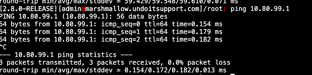

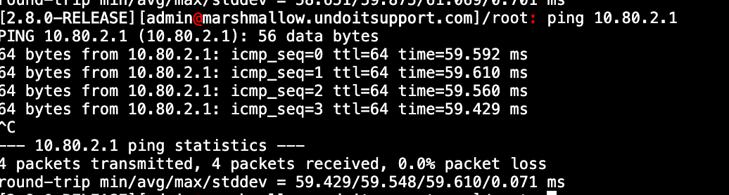

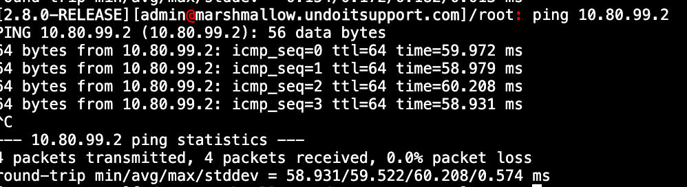

      Currently the IPsec VPN is up, P2 is installed on both sides of the connction and from Gateways I can see the Gateways are both online with no packet loss. If I SSH onto Site 1 I am able to ping the QNAP device with no issues, and from my mac on site 2 I am able to ping the remote pfsense local IP, along with being able to ping both gateways from either end.

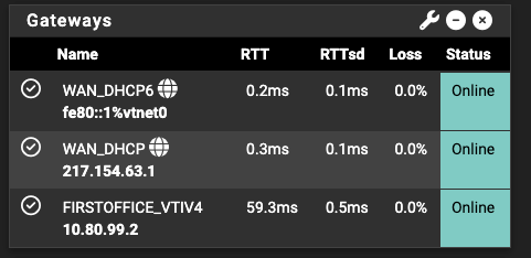

      Site 1 - Ping Results & Gateway Monitoring
      Gateway to site 2 is up and running with a roundtrip of around 60ms
      Pinging site 2 pfSense box showing a similar average:

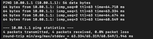

      Ping site 1 Gateway IP:
      Ping site 2 Gateway IP:

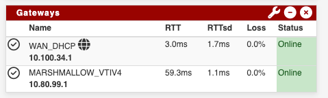

      Site 2 - Ping Results & Gateway Monitoring
      Gateway to site 1 is up and running with a roundtrip of 60ms:

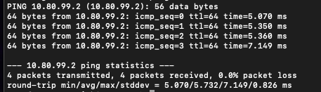

      Site 2 - Ping from Site 2 to Site Gateway:

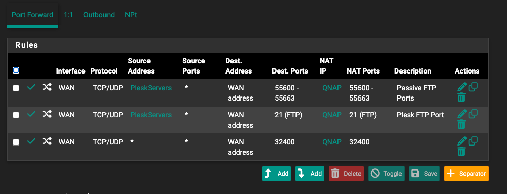

      This is going to be the entry point to the network this is where I have created the Port Forwards for the FTP access onto the QNAP on site 2.
      Port Forward Rules:

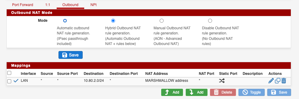

      Outbound NAT is set to Hybrid and I have added the following two rules that I was advised in my previous post:

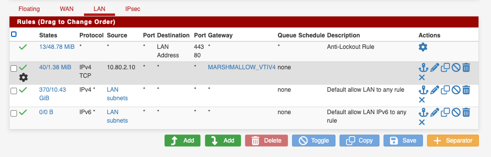

      Site 2 - Firewall / NAT / Rules
      I have configured the QNAP device to use Site 1 as its remote gateway so that all traffic sent by the device will get send over the link and exit from site 1.

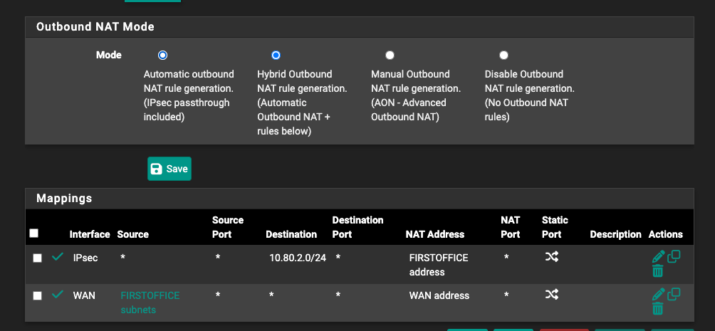

      Outbound NAT is set to Hybrid and I have added the rule that I was advised in my previous post.
      LAN Firewall rules to route all QNAP traffic via the VTI Link:

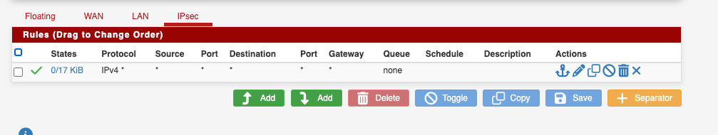

      IPsec Firewall rules
