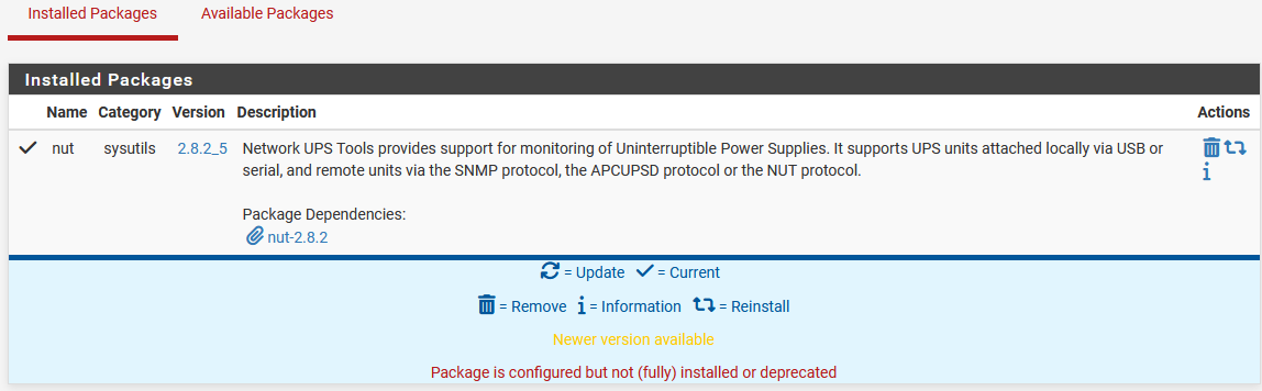

          [2.8.0-RELEASE][admin@janus.jhmg.pvt]/root: pkg info | grep nut
          nut-2.8.2                      Network UPS Tools
          pfSense-pkg-nut-2.8.2_5        Network UPS Tools
          Here's what Package Manager has:

            @jhg said in NUT fails to start after 2.7.2 -> 2.8.0 upgrade:
            These are good.
