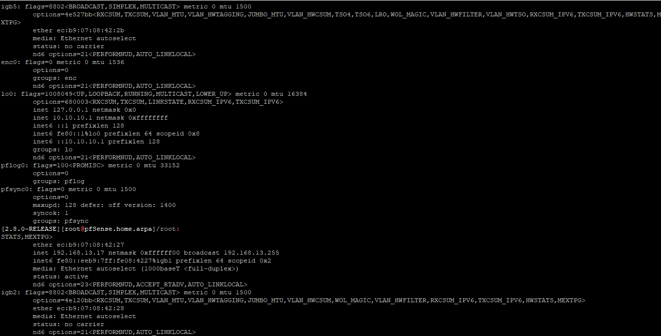

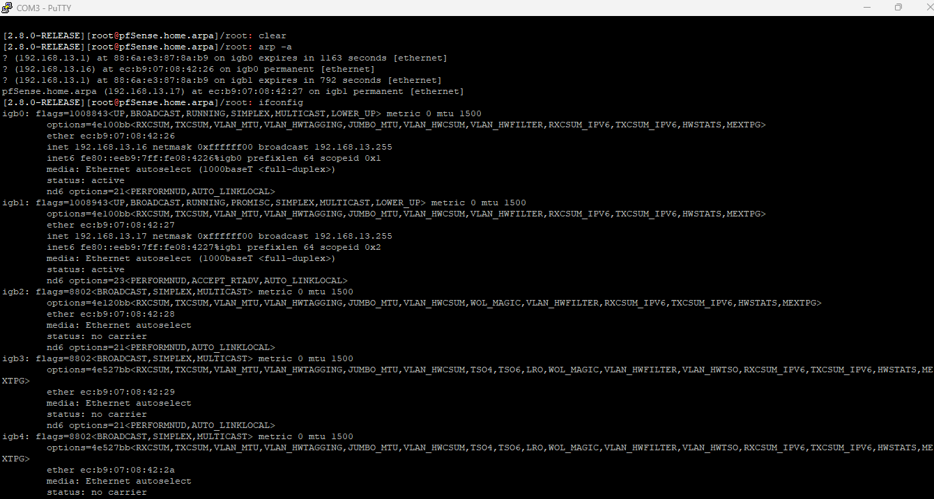

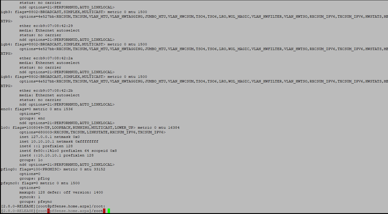

            • E Offline
              EndUserOnly @stephenw10
              @stephenw10 Screenshot 2025-08-04 144637.png Screenshot 2025-08-04 144800.png Screenshot 2025-08-04 144940.png
              • E Offline
                EndUserOnly @EndUserOnly
                .17 is my LAN, .16 is my WAN. I do not remember .17 being there before. Did not change situation. I did resets on both the interface and IP address today (still trouble shooting). No change.
