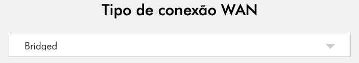

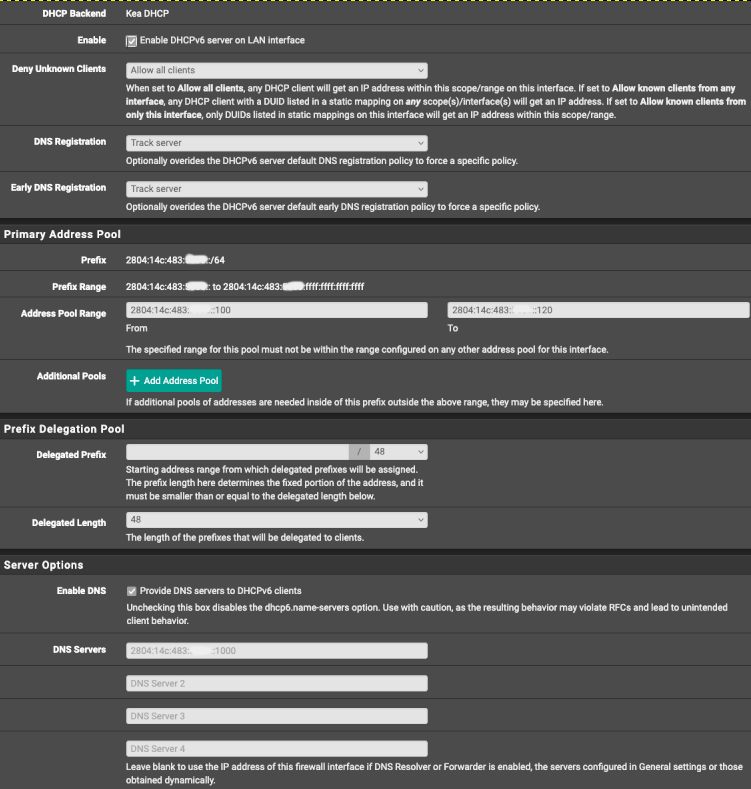

      Olá! My ISP modem is configured in bridge mode. For IPV4 is working very well, but now I am trying to also use IPV6, but pfSense is not distributing the IPV6 and not setting the gateway. My pfSense is running in a VM behind proxmox.

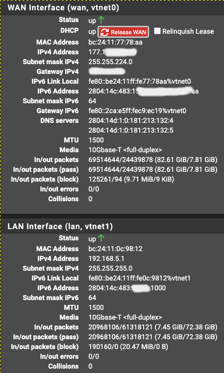

      Interface status:
      WAN Interface:
      LAN Interface is set to use static IP.
      DHCP6 server:

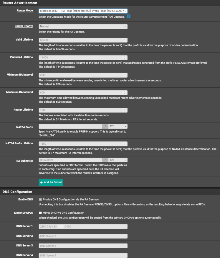

      Router Advertisement:

        You ask :
        but you still got a IPv6 on your WAN.
        You don't want a IPv6 for your WAN ?
        First time I see the option activated. ISP instructions ?

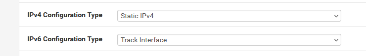

        Static what IP ? IPv6 IPv4 ?
        Normally, the IPv6 on your LAN should be set to :
        Btw : you didn't mention your ISP. Be ware that every ISP out there handles IPv6 differently, so it impossible to check or see issues.

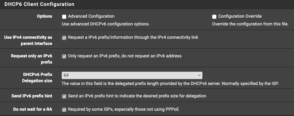

        Your WAN uses dhcp6c ?
        Then, if you want answers : System > Advanced > Networking and check :
          If I uncheck this option the WAN gets a /128 IPV6.
          Should I uncheck the "IPV4 connectivity?
          If I set to "Track Interface", the LAN interface didnt get any IPV6 address, thats why I set to static IPV6.
          I going to enable the debug mode.

            Change your DHCPv6 Prefix Delegation size to whatever your ISP provides. With 64, you will only get one subnet. My ISP provides /56 for 256 subnets, so I use 56 for my size.

              @cezarq said in DHCP6 server and gateway not working with ISP modem in bridge mode:
              That's entirely normal. You don't need a global address on your WAN, but it's useful for setting up a VPN, etc..
              I'd recommend you uncheck it.
