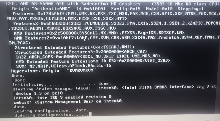

        • yon 0Y Offline
          yon 0 @stephenw10
          The system has been stuck at this point with no progress since the upgrade and reboot.
          how i do next step?
            Try pressing ctrl+t
            Does it respond? What is it waiting for?
            Do you have large or complex config? Has it run in 25.07 beta or RC?
            yon 0Y 2 Replies Last reply Reply Quote 0

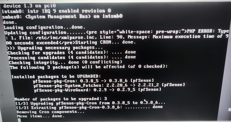

              • yon 0Y Offline
                yon 0 @stephenw10
                now it is here:
                  Hmm, OK so it hit an error during the config upgrade but eventually continued when PHP hit time limit.
                  It looks to be continuing.
                  Are you able to send us that config to review/test?

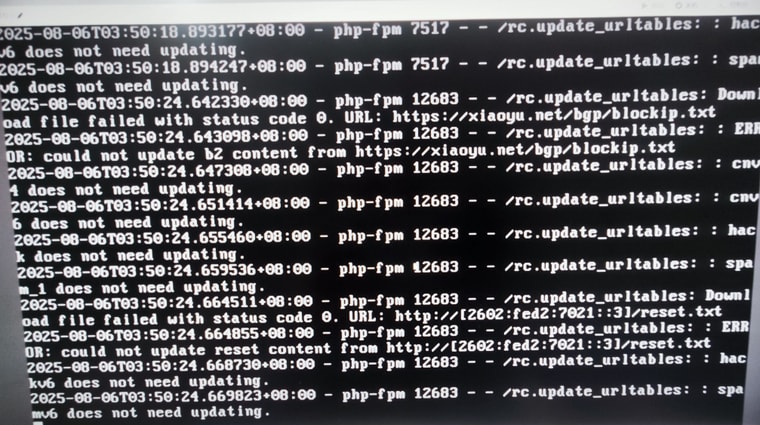

                        • yon 0Y Offline
                          yon 0 @yon 0
                            Hmm, I can't replicate that here. Running the config upgrade against your config completes without error in a very short time as expected.
                            That new screenshot looks like it doesn't have access to those URLs. Maybe the files no longer exist?

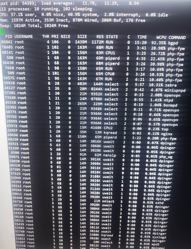

                              • yon 0Y Offline
                                yon 0 @stephenw10
                                @stephenw10 said in 24.11 upgrade to 25.07:
                                There is a local network, but pfsense has not been started, so the network files cannot be used. Now after restarting the vps, pfsense has been started, but the system is very slow and the CPU is fully occupied
