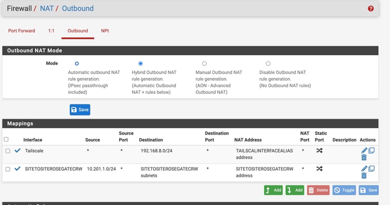

      I had to restore a backup after I lost some hardware -- I thnk this might be where the issue came from
      I think this might be the first reboot that has occurred after the setup
      Here's the error:
      18:15:59 There were error(s) loading the rules: /tmp/rules.debug:95: macro 'TAILSCALE__NETWORK' not defined - The line in question reads [95]: nat on $Tailscale inet from $OPT1__NETWORK to $TAILSCALE__NETWORK -> (Tailscale) static-port
      But screenshots on my NAT page don't show the culprit.
      Was able to get to the file /tmp/rules.debug but wasnt sure how to or even if I could edit the file
      As noted in the sceenshot I don't even have and "static ports" defined in the settings BUT I think I might have in my prior setup for restoring a backup (I had to manually recreate a number of things to get the restored backup to work)
      Just woud like to fix so that I quit getting the notification of the error

        It's almost certainly because at the first boot it had not yet installed the Tailscale package when it first loaded the ruleset.
        If that error doesn't re-appear after clearing it and the tailscale package is now installed then it's nothing to worry about.

          So the error keeps recurring
          Any way to get rid of whatever rule is trying to be laoded (probably form the backup)??

          20:05:32 There were error(s) loading the rules: /tmp/rules.debug:95: macro 'TAILSCALE__NETWORK' not defined - The line in question reads [95]: nat on $Tailscale inet from $OPT1__NETWORK to $TAILSCALE__NETWORK -> (Tailscale) static-port
            Do you not have Tailscale installed?
            Do you have the tailscale interface assigned? You should not if you do.

              I do have Tailscale installed
              And I do assign the Tailscale assigned as an interface
              The purpose is for it to assigned as a gateway for a static route for one of my external networks
              (Basically utilizing Tailscale as a site to site for that particular external network)
              It has worked well for quite some time
              The error based on the naming appears to be hold over from the prior backup though
                Mmm the tailscale interface should not be assigned. Usually doing that causes boot to fail because the interface doesn't exist when the interface-check runs. I'm not sure how that isn't happening here but that rules error is likely caused by the same thing. In tailscale all the routing is expected to be handled by tailscale itself.

                  Ok. Makes sense
                  I was advised by Tailscale support that I might need to establish NAT rules and a static route in pfsense if I wanted to force pfsense to use TS as a gateway for one of my other subnets on another one of my TS networks.
                  If I know the TS address of my local network is 100.xxx.xxx.xxx
                  Then how would you propose to establish that address as a gateway and then to use that address as a gateway for a static route for a subnet on an external 192.168.8.0/24 subnet (also on my TS network) ?
                  (Other than the error the routing is occurring properly now)

                    Hmm, I'm not sure why you would need NAT there if each site is advertising the correct subnets. But yes that would be a problem if you needed to do it. In pfSense you need to assign an interface to apply NAT on it.
