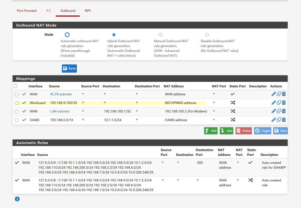

      Just noticed recently that in the Outbound NAT page, if you use Automatic NAT or Hybrid NAT, there's an automatic NAT rule for ::1/128.
      If you have IPv6 working and the router has a GUA IPv6 address what is the point of this NAT rule?

        @IonutIT because ::1/128 is the localhost address.. just like you have an outbound nat for 127.0.0.0/8 which is the localhost IPv4 address range, normally local host would be 127.0.0.1, but really anything 127.x can be used as localhost address. With ipv6 the localhost range is just /128
        if you source traffic from your localhost address it needs to be natted to the IP of the interface its leaving on. For example I use localhost for outgoing interface in unbound. Which gets natted to wan IP when unbound looks up something
