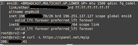

      On PFsense 2.7.2 CE (206.x.y.41/29), I have BGP running, and setup some hosts on the BGP subnet. For some strange reason, I cannot NAT disabled. Hence, when host on one of the other public IP subnets (196.x.y.70/26 or 196.x.y.66/26) connects to the internet, is is seen as the internet gateway, i.e. 206.x.y.41/29.
      This causes major issues as the traffic is NAT'ed. cPanel, for example cannot license the server as
      the wrong IP comes up.

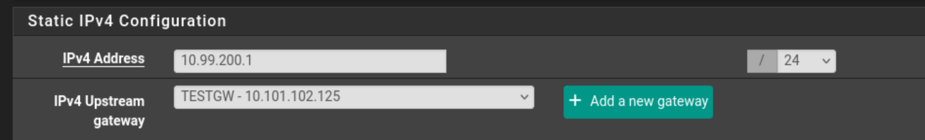

            All I can say if you set a gateway in the interface settings (see screenshot) then pfSense creates NAT rules automatically, if outbound NAT is set to automatic or hybrid.

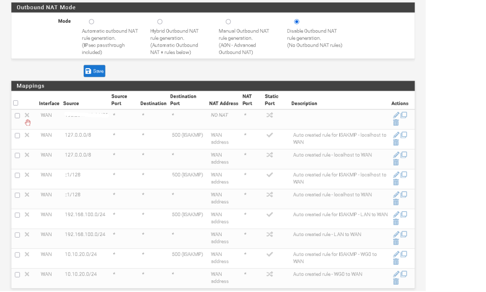

            But since you have disable outbound NAT I can't see your traffic being NAT-ted at all.
