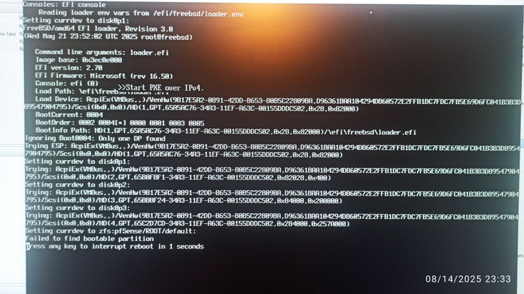

      Yesterday, I tried upgrading from 2.7.2 to 2.80 directly in GUI and after this it won't boot anymore... According to the update log everything should be OK and finished successfully, but...
      I am running it on a Hyper-V and this is the error at the moment:
      Is there any chance to recover from this situation?

          The upgrade log shows that UEFI boot entry 0002 was marked as active:
          Updating boot code...
          /usr/local/sbin/../libexec/install-boot.sh -b auto -f zfs -s gpt -u da0
          gpart bootcode -b /boot/pmbr -p /boot/gptzfsboot -i 2 da0
          partcode written to da0p2
          bootcode written to da0
          ESP /dev/da0p1 mounted on /tmp/stand-test.3IL7PZ
          264752KB space remaining on ESP: renaming old bootx64.efi file /efi/boot/bootx64.efi /efi/boot/bootx64-old.efi
          264752KB space remaining on ESP: renaming old loader.efi file /etc/freebsd/loader.efi /etc/freebsd/loader-old.efi
          Copying loader.efi to /EFI/freebsd on ESP
          Creating UEFI boot entry for FreeBSD
          Marking UEFI boot entry 0002 active
          Copying bootx64.efi to /efi/boot on ESP
          Unmounting and cleaning up temporary mount point
          Finished updating ESP
          But that screenshot shows it's trying and failing to boot 0004. So the first thing I would try is setting 0002 as the active boot value.
