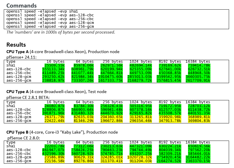

      Please see the results of my openssl speed tests:
      I am seeing a massive performance regression in AES-GCM in pfSense 2.8.0 and 2.8.1-BETA.
      I have two boxes in production and a test box. The production box on pfSense+ 24.11 is fine. I have a test box exactly the same as that one, which I am testing a new firewall build on, and I did some crypto speed tests and was floored with seeing a 10x decrease in speed for AES-GCM!!! Both have AES-NI enabled and apparently working. The AES-CBC results between the two are similar. It's just the AES-GCM that is terrible... and that is the cipher standard I use.
      I then jumped on another production box that uses different CPUs, but still 4-core, and ran tests. It's on pfSense CE 2.8.0 (but thinking of upgrading that one to Plus). The results are also extremely poor for AES-GCM, but again AES-CBC is fine. The AES-GCM one does improve at 8192 bytes size, and is fine at 16384 bytes though. Weird.
      I don't think this is a CE vs Plus thing , as I have results from all this gear from and older version of pfSense where all of it was testing fine. I didn't record the exact version of pfSense for that one (2.6.x??), but it was definitely from a time before we upgraded anything to Plus.
      Seems to be a newer kernel thing. Something is broken, and I am hesitant to upgrade the Plus box to 25.7 if the new version has an issue with AES-GCM.
      Anyone care to do their own testing and share results? Or shed light on what might be going on? Thank you.

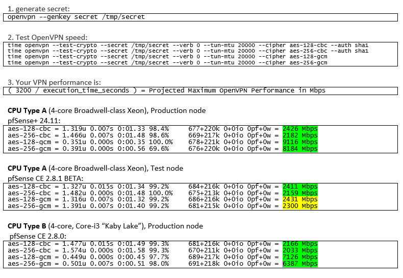

        I did the timed theoretical throughput tests for OpenVPN, and this is what I got:
        Again, the AES-GCM results on the test node with CE 2.8.1-BETA seem to be well below what is to be expected.

          OK a third post to myself. Seems like this is a known issue, at least to some with web searching skills...
          https://github.com/openwrt/openwrt/issues/18929
          The box that is always testing fine shows this output, from "openssl version"
          OpenSSL 3.0.14 4 Jun 2024 (Library: OpenSSL 3.0.14 4 Jun 2024)
          The other two (that report speed problems) have:
          OpenSSL 3.0.16 11 Feb 2025 (Library: OpenSSL 3.0.16 11 Feb 2025)
          The summary in the linked URL is:
          This performance degradation is only reflected in the speed test program that comes with OpenSSL and does not affect the actual performance.
          If it is caused by a bug fix in the test program, it should be OK, but it will cause some users to misunderstand that there is a performance problem.
          Reading this https://github.com/openssl/openssl/issues/28063 I've learned that there was an intentional change from 3.0.15 to 3.0.16 due to prior results being "erroneously high because much of the decryption effort was skipped" but I believe that their implementation is buggy, because of how poorly GCM compares against CBC for the low byte sizes - there's no way that CBC can beat GCM by that much (a factor of 20x) for the 16 byte size.
          Anyway I hope more people complain to OpenSSL devs, and they can fix this up in 3.0.17. At least it's only just the testing that gives bugged results, and that real-world performance supposed to be fine.
