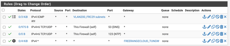

      This is probably a silly problem, but for the life of me I cannot figure out how to get the internal services subnet to respond to the outside world, even the router (which is configured to permit any ICMP packets, and responds appropriately on its own WAN IP). I am able to talk to it internally from a typical private-IP subnet. I don't see any obvious firewall "this is blocked" log messages, either.
      Are there some obvious firewall rules that I am missing?
      VLAN ID: 200
      Subnet: a.b.c.160/29
      Router: a.b.c.161
      Test box: a.b.c.164
      VLAN 200 Firewall:

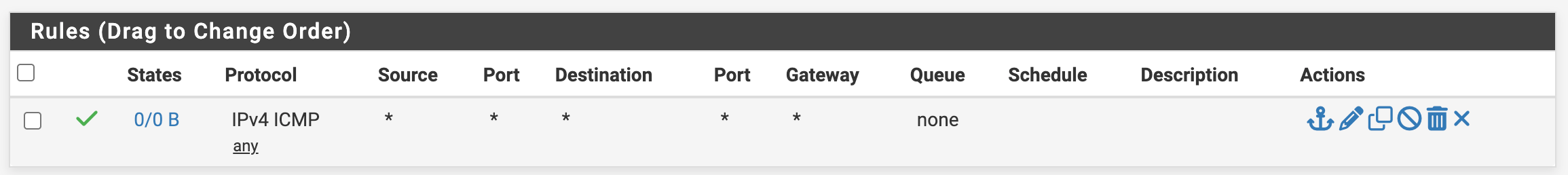

      Tunnel interface firewall:

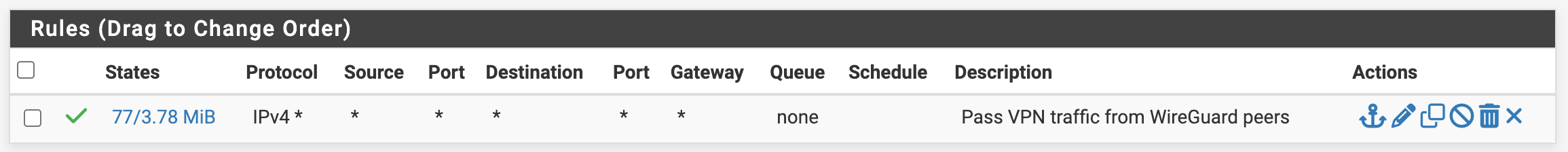

      Wireguard firewall:

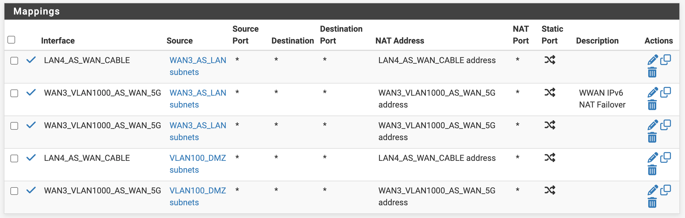

      NAT:
