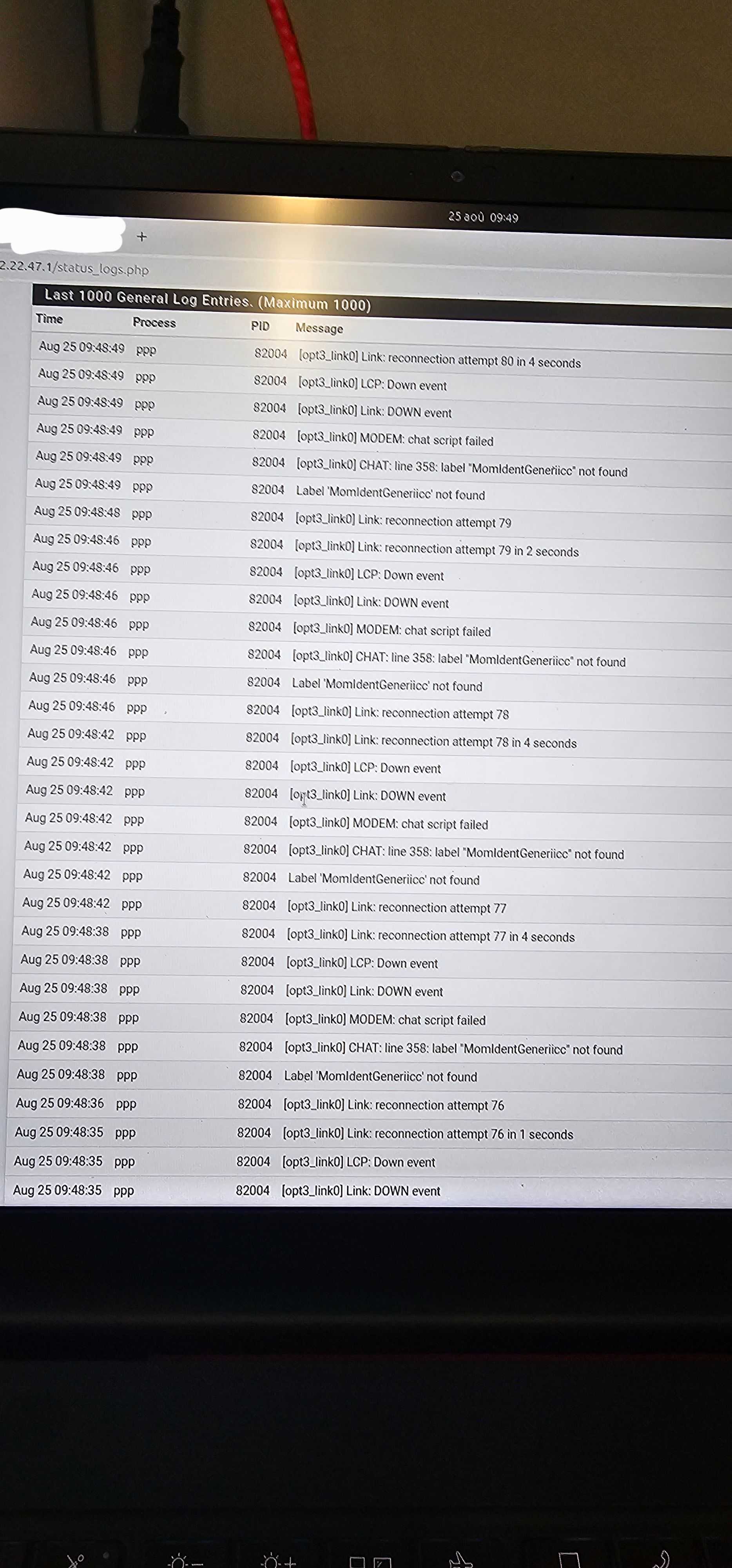

                  Update :
                  Upgrade on 3 units worked correctly. LTE is now down.

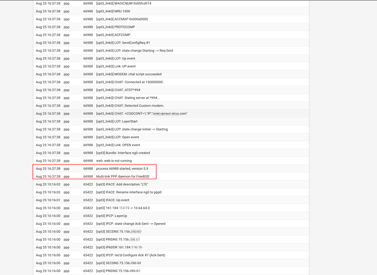

                  After searching for the error message I found https://forum.netgate.com/topic/174804/ppp-log-weird-things-omdentggeneeriicc-atmoecmd-laabeell-solved
                  Using &F&C1&D2E0S0=0${temp} LTE connections are back, however they are too unstable to be used in production.
                  Not sure what's going on but that update broke something. I will have to downgrade to 2.7.2.
