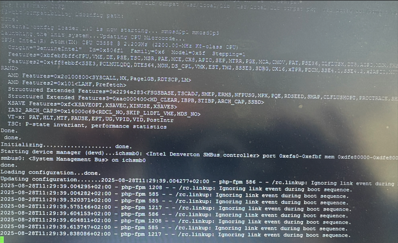

        Remember the most important cable that came with the 7100 ? (The console cable ^^) : connect it, and try to re upgrade using the console menu.
        Tip : have what is shown on the screen also logged to a file for later analyses.

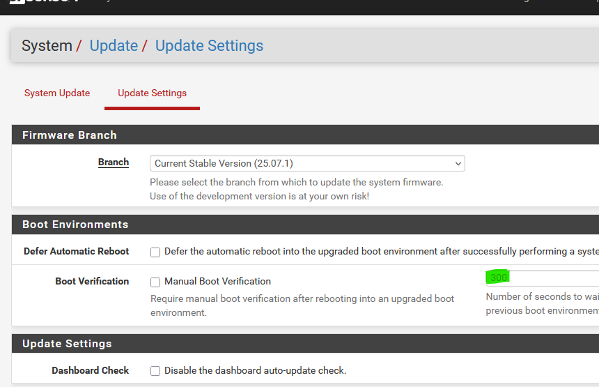

        What probably/might have happened : it booted into the new 25.07.1 "ZFS" environment and it had to succeed within :
        (300 second) and if that's not the case, it boot back into the previous env.
          Yes, it probably failed the boot verification check after booting into the upgraded BE. Which means it's not a drive space issue. But you should see an alert on the dashboard if it fails to boot check and rolls back.
          You would need to see the boot log from the new BE to see where it's failing.
