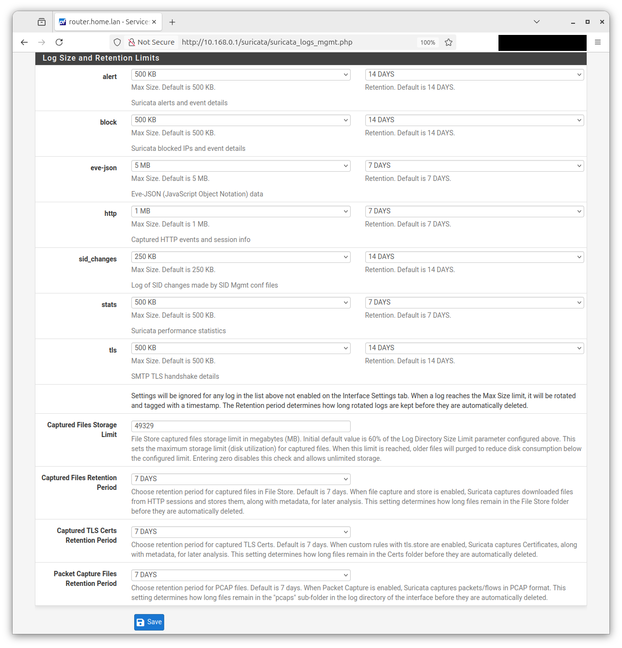

      As far as I can tell, the retention settings have not been touched from the defaults:
      (The Auto Log Management checkbox at the head of the page is definitely checked. The Log Directory Size Limit box is not.)
      However, the logs for my WAN interface have gone a teeny wee bit past those limits:

        SteveITS Rebel Alliance @Smeg.Head
        @Smeg.Head Have you tried saving the log settings page as is? Years ago IIRC there was a bug there also where it needed saving.

          Smeg.Head @SteveITS
          @SteveITS No, I haven't, but I'll do that now. It never occurred to me that if it was already showing a bunch of limits, it might still need the save button pushed.
