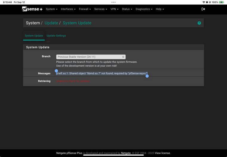

      I’m getting this message ld-elf.so.1: Shared object "libmd.so.7" not found, required by "pfSense-repoc" on the update GUI when trying to check for updates. I may have earlier clicked update, and since I got no response, clicked away.
      I can still ssh in at the moment, and disk is not full. I have not rebooted yet.

          I can't proceed from there... the button never shows due to the error.
