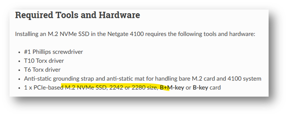

      https://docs.netgate.com/pfsense/en/latest/solutions/netgate-4100/m-2-nvme-installation.html#netgate-4100-m-2-install-wipe-mmc

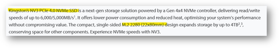

      I purchased this high quality Kingston NV3 SSD which met the 2280 form factor but it will not insert as per the images below.

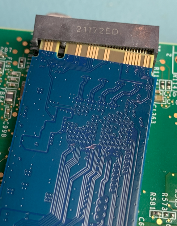

      If the slot is aligned, the RHS of the PCB will not insert – does this Netgate have the correct socket soldered to the PCB?

        You need am M+B Key NVMe SSD not only a M Key like you try.
        Wrong SSD.

          @NOCling OK thanks I figured 2280 form factor would have that covered.
            Yup the slot is B-Keyed to allow fitting wifi devices. Most NVMe devices are M-Keyed only. So you need an NVMe drive that is M+B Keyed to fit. You could potentially use a B-Keyed NVMe drive but I've never seen one of those. 😉
