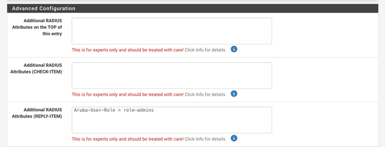

                            • keyserK Offline
                              keyser Rebel Alliance @SteveITS
                              @SteveITS It’s there - its only a question of how to use it. I have done some Freeradius config previously, and I had freeradius return an Aruba hardware specific radius attribute to the Accesspoints. When I did that, all I had do to was use this field on the user object in freeradius:
                                SteveITS Galactic Empire @keyser
                                @keyser Ah. Silly me I was looking for "class" :)
