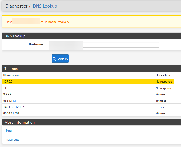

      Backup node web interface is extremly slow.
      Turning on maintenance mode on the master, will resolve the issue on the backup, but the DNS resolution will be unreliable on the master. So the issue always occurs on the current pfsense in backup status.
      The Backup Firewall is in most cases not able to get update informations for system or packages.

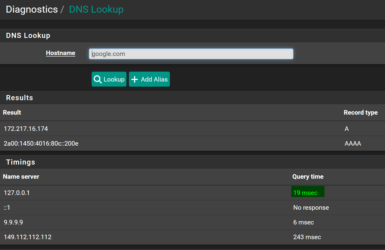

      Master with working DNS
      Backup with mainly unusable DNS, no response from localhost

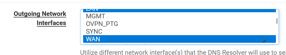

            Resolver mode seams to need the WAN interface enabled on Outgoing Network Interfaces.
            • B Offline
              benbrummer
              It looks like the resolver mode is irrelevant, but in the HA cluster the Wan interface is required the be selected as Outgoing Network Interface
              HA Cluster
              Outgoing Network Interface: LAN, WAN, Localhost
              Single Node
              Outgoing Network Interface: LAN, Localhost
              Without WAN the backup pfsense fails to resolve DNS.

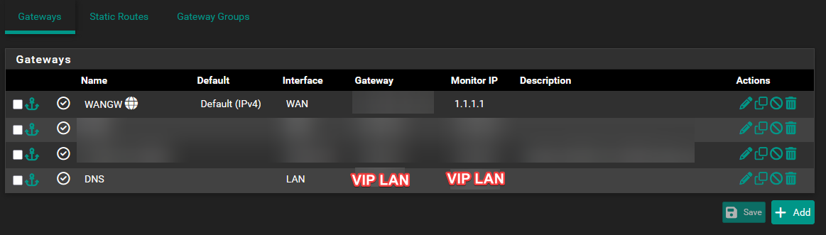

                              • B Offline
                                benbrummer @benbrummer
                                Current status: It works now
                                1. Created a GW for Interface LAN with the VIP for LAN. The ACL on other pfsense expect that queries originate from this IP
                                2. Created an alias, holding all our internal DNS servers on other locations
                                3. I created a static root for the new gateway to this alias
                                4. Same was done for another interface and an alias for the partners DNS servers

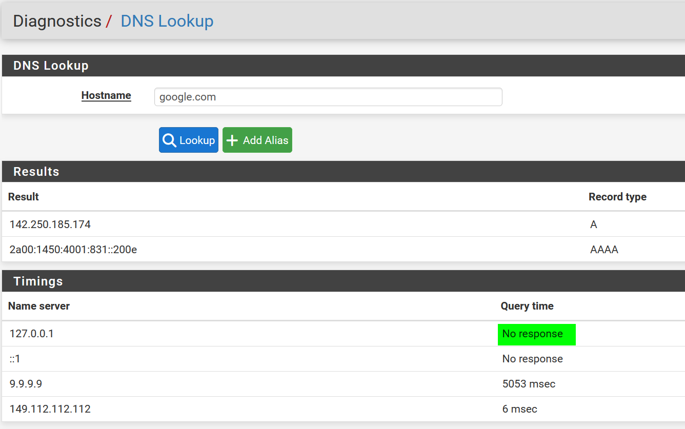

                                • B Offline
                                  benbrummer
                                  DNS for internal servers is not working on the secondary
                                  • traceroute 2 hops
                                  • ping works
                                  • Public DNS works fine, Interface is responsive
                                  primary works great, with
                                  046dfb22-7108-4283-a549-88b72d3fb98e-image.png and a static route
