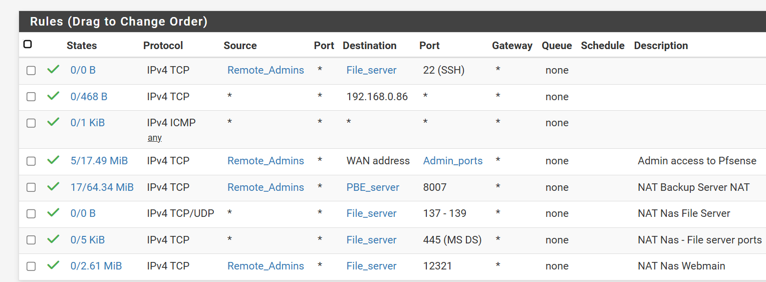

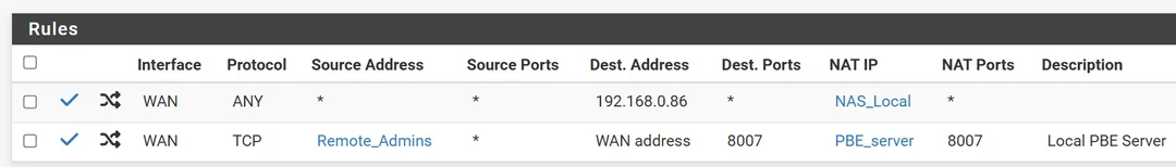

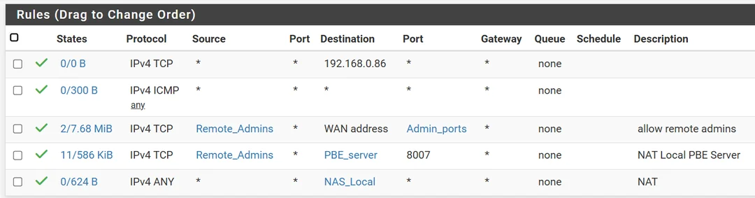

      I defined the following virtual ips
      I have the following NAT set up:
      And the following rules:
      I can't ping the .86 IP address or ssh. If I do it from the local net (172.16...) its fine, so it appears to definitely a firewall/routing issue.

                    You can't ping the VIP? And you added firewall rules to allow it?
                    Perhaps something in the hypervisor is blocking it?

                          F figured out the problem. I was using an IP alias for the target of the NAT redirect target. If I placed the actual value value into the target, it works. Its a bug.
                          The inability to ping was the proxmox node firewall was on. I thought I had turned it off.

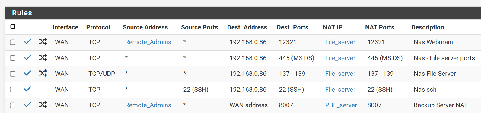

                                  @SteveITS I have everything working, but the ssh forward does not work. I can access the server through the webadmin interface, but not ssh 192.168.0.86, it fails. I tried the first rule
                                  When I try to access webmin through port 12321 it works, from the same address ssh timesout.
                                  Any suggestions?
                                    You should not have a source port set in the port forward for it. The source port is almost always a random ephemeral port.
                                    W 1 Reply Last reply Reply Quote 3

                                      williamsilverstein @stephenw10
                                      @stephenw10 That was the problem. Thanks.
