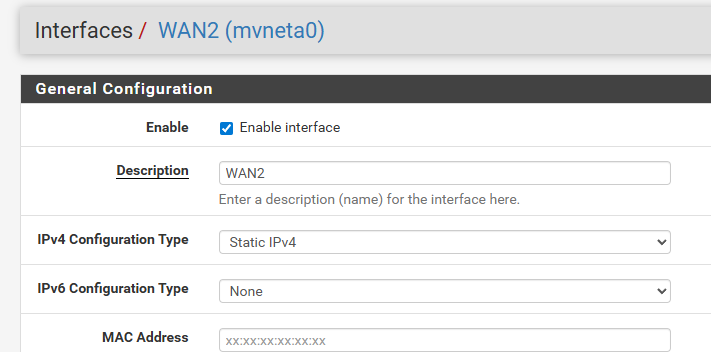

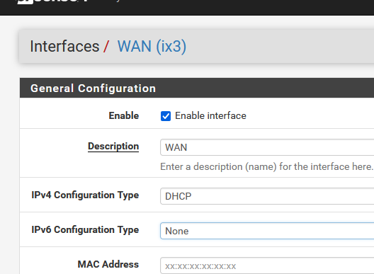

          The pfSense WAN2 (you've called it LAN1) : can you set to :
          and then connect it (pfSense WAN2) to the to "Three 5G router" LAN port, and then check here :

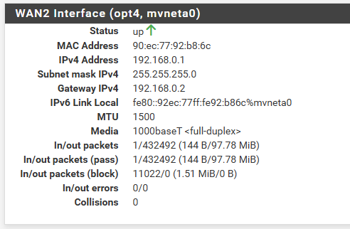

            And this is the current status.

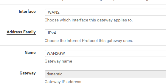

              And then this is what I get for the gateway
              where 192.168.0.2 is the IP address of the Three %G Modem.

                    MartynK @MartynK
                    So deleting the gateway and recreating it I have managed to get it online,

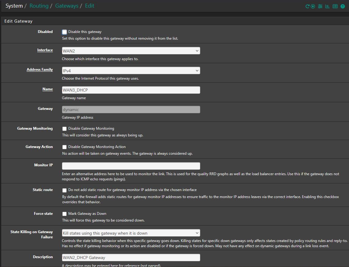

                      This is my gateway.. It was at one time a WAN 3 here so the name cannot be changed unless I start over with it which I haven't done. But ignore that.
