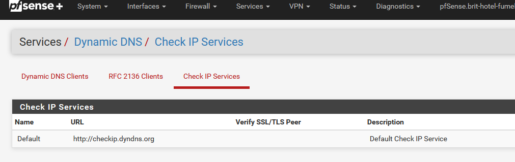

      My Dynamic DNS client is failing to update after a recent IP change. In digging through the logs I found this error "Dynamic DNS () There was an error trying to determine the public IP for interface". I tried manually running the check IP service URLs and their are certificate errors. Although I do not have the option "Verify SSL/TLS Peer" checked for any of the Check IP Services that I have tried.
      I can't figure out why this used to work for years and suddenly just stopped working. I haven't changed anything.

        pfSense uses this URL :
        and web site is protected against certificate problems : it doesn't use them ๐Ÿ˜Š
