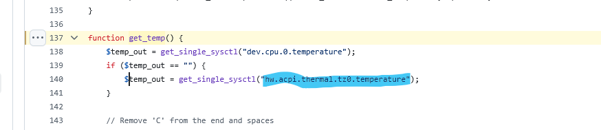

        It's here :
        The GUI gets it's info from here.
        On my 4100 :
        [25.07.1-RELEASE][root@pfSense.bhf.tld]/etc/inc: sysctl dev.cpu.0.temperature
        dev.cpu.0.temperature: 50.0C

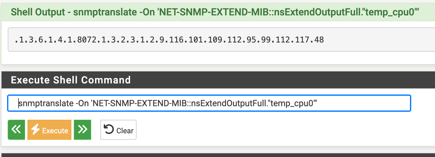

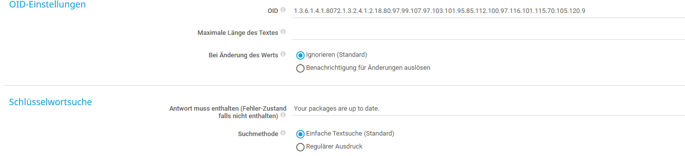

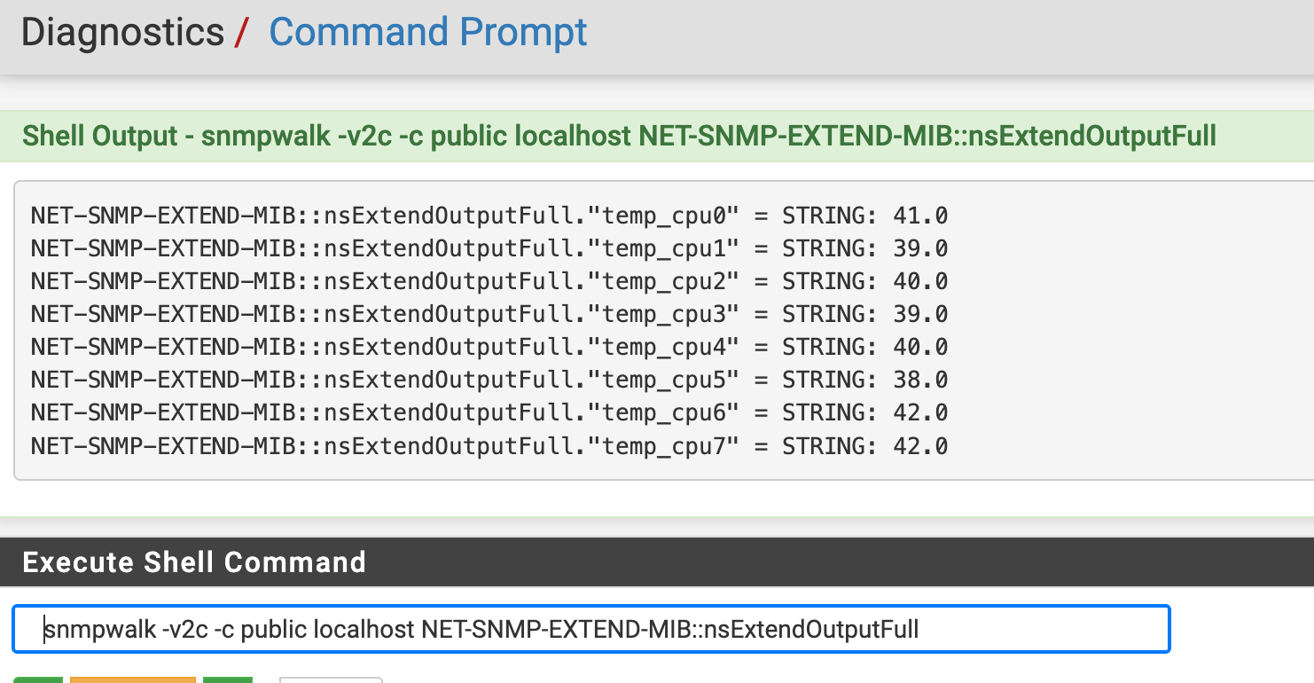

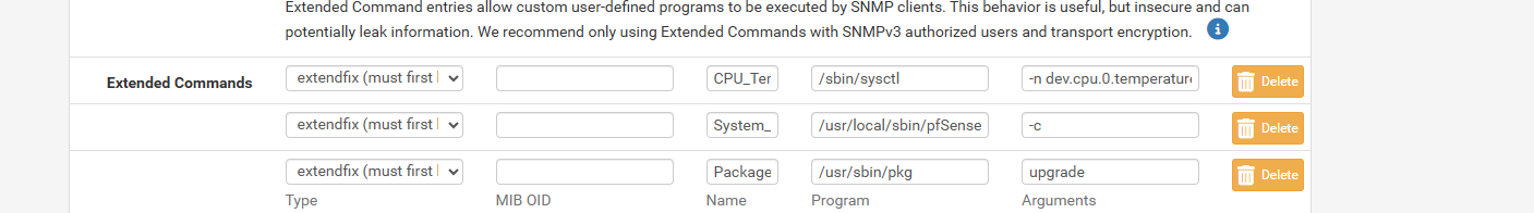

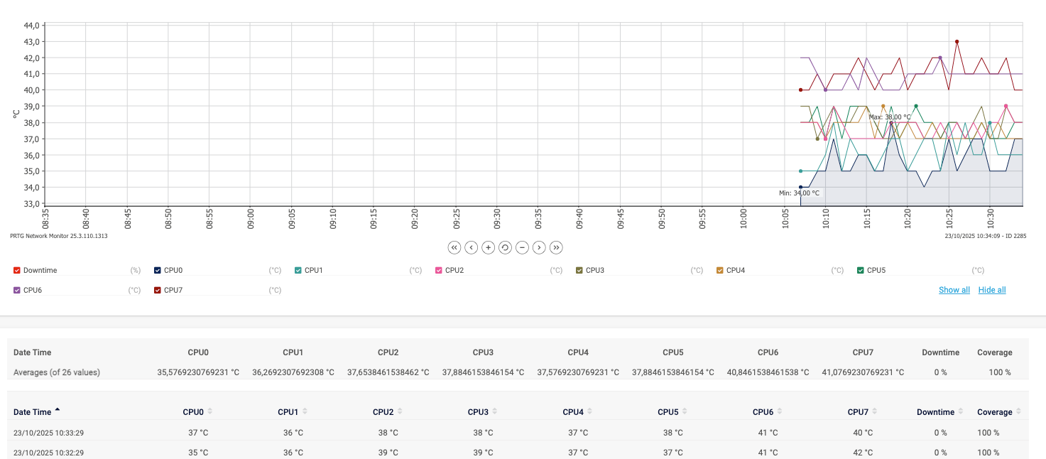

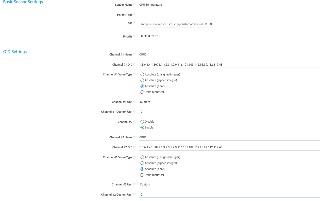

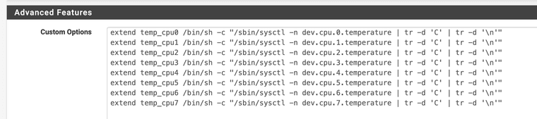

          OpIT GmbH
          We are using NET-SNMP und PRTG
          CPU_Temperatur
          /sbin/sysctl -n dev.cpu.0.temperature | tr -d C
          System_Updates
          /usr/local/sbin/pfSense-upgrade -c
          Package_Updates
          /usr/sbin/pkg upgrade

                Gertjan @Joe0x7F
                @Joe0x7F said in How to read CPU temperature on 1100, 2100, and 4200?:
                <NOTHING DISPLAYED>
                If nothing comes back, the GUI executes another command.
                You tested that one ?
