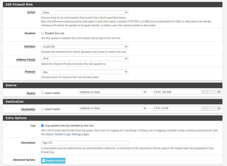

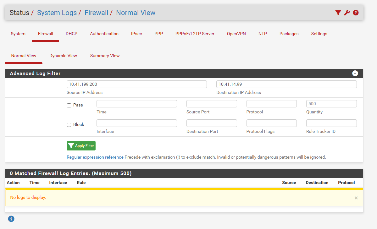

                  Is the firewall logging anything? If you create some other rule as a test with logging does it work as expected?

                    @stephenw10 Yes, it does. And weirdly enough, some packets in this rule are logged, while others are not. I tried from two different public IPs to nc -u <IP> <port> and one got logged, one didn't, even though in States I see both of them.... What's going on?! :D
                    P.S. It can't match a different rule - one that is not logging let's say - because ALL my rules are set to log. So no matter what rule it'd match, I'd have to see it in the logs.

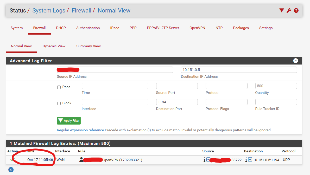

                    When I opened this forum post I tried to reach the machine from a certain public IP. That was on the 17th of October. I can still see that log line. If I open a new connection (different source port, naturally), the traffic is forwarded properly, the traffic reaches the target machine, but I don't see the connection in the logs, even though I see it in the states.
                    P.S. could it be an issue that the target machine doesn't reply? Since this is UDP, I get no reply from the target....?

                            So it seems to match the correct rule
                            While the logs only show an old connection from October 17th.
