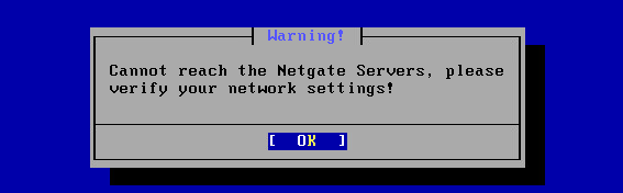

      I’m trying to install pfSense 2.8 (Community Edition), but during installation I get the error:
      Cannot reach Netgate servers. Please verify your network settings.
      I’ve tested the network connection—internet and DNS both work fine.
      However, the installer cannot contact pkg.pfsense.org or services.netgate.com.

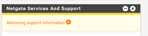

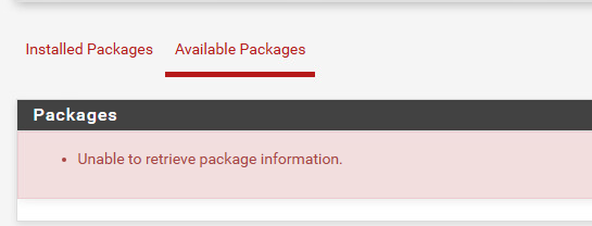

          Installed Packages
          Available Packages
          Packages
          Unable to retrieve package information.

              @Gertjan Then where does pfSense actually pull its packages from?
              I think this is connected to the issue I'm having — I can’t install pfSense 2.8 at all, and on 2.7.2 I also can’t install any packages.
              pfSense 2.8
              pfSense 2.72
              I can also reach 208.123.73.87 from another IP address (different network, different Internet provider, and a different location).
              *tracert 208.123.73.87
              Tracing route to services.netgate.com [208.123.73.87]
              over a maximum of 30 hops:
              *1 2 ms 2 ms 2 ms ...
              12 155 ms 155 ms 155 ms services.netgate.com [208.123.73.87]
              Trace complete.*
              Do you think this could be an issue with my ISP?
              I’d really like to know exactly where pfSense pulls its packages from, and what address my WAN needs to contact in order to download packages and access Netgate Services and Support.
