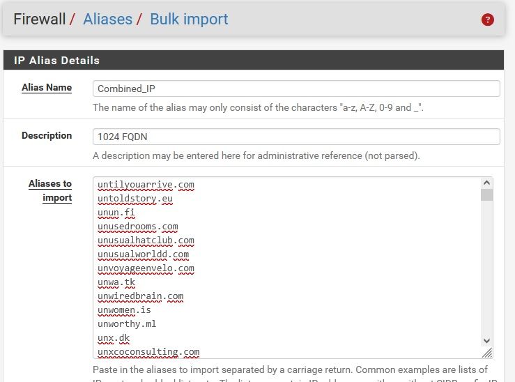

                            After more testing I suspect the root cause of the bug investigated in this thread is
                            • An alias containing one or more FQDN is limited to a little over 512 entries (total across all such aliases), not the 5000 per alias limit suggested in the manual.
                            • if you go over that limit further alias table updates are blocked for all aliases
                            For the duplicate removal but not restored bug discovered again in this thread, and referenced in your thread, I can't see that being resolved any time soon. Learning how best to live with it is more sensible imo.
                            Easy bug trigger
                            Tested in a clean pfsense v2.8.1 install, enable WAN GUI access. Save that configuration as baseline. Done to ensure easy repeatability and reduce the validity of the shooting the messenger crap.
                            The easiest way of triggering the bug is entering the following 1024 consecutive element alias -> 473 element are shown in the corresponding alias table.

                            Reload the baseline configuration and enter a 1024 FQDN, I copied the first 1024 entires form pfblocker. -> 569 records after wait about 1 hour and lots of filter reloads. After which
                            • "killall filterdns" -> No matching processes were found
                            • create an Test_loaded containing a single FQDN -> empty alias table
                            Which strongly suggests "mixed mode" alias are no different to pure FQDN aliases, just testing takes longer.
