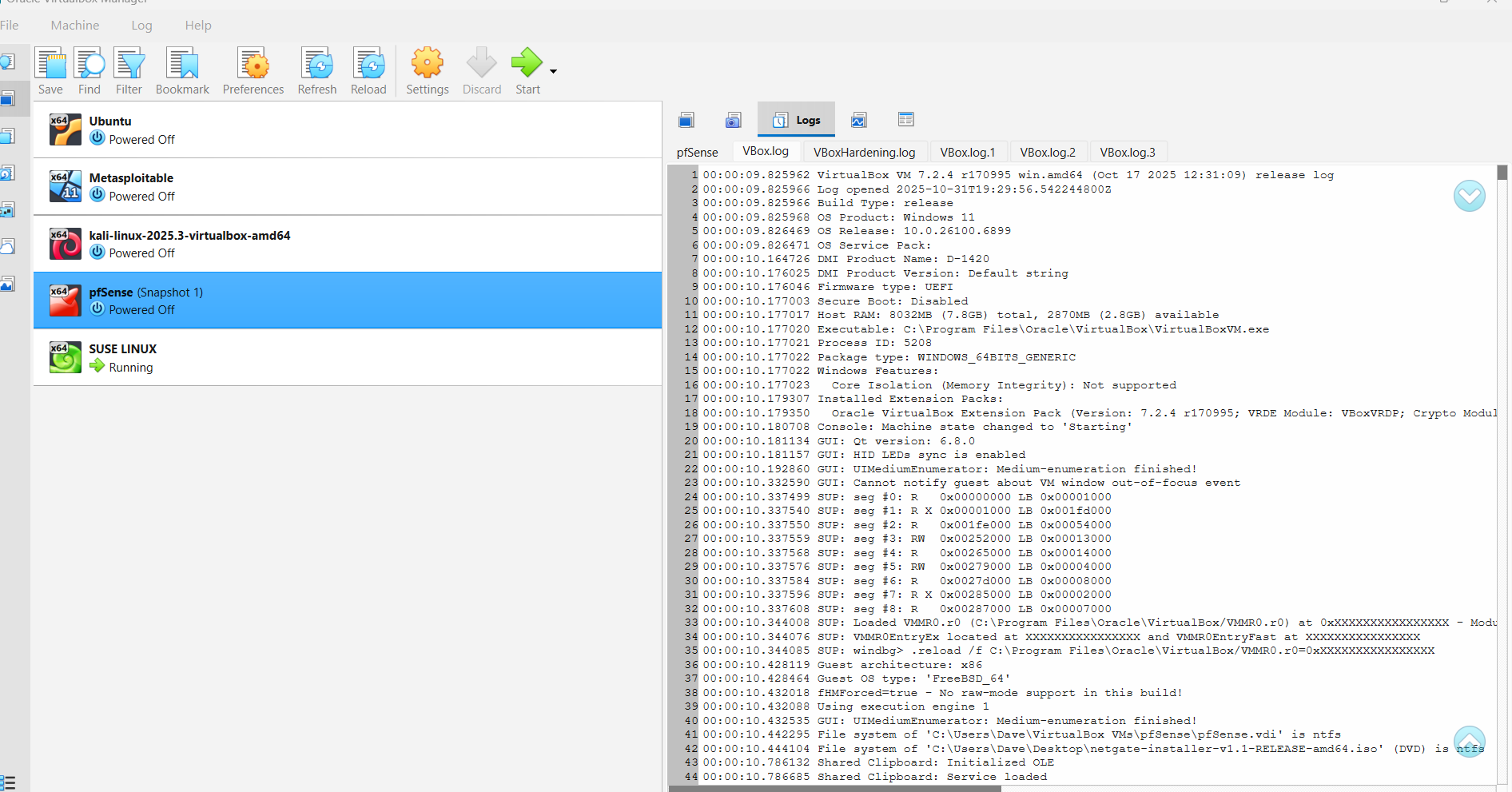

              The attached screenshot shows some log tabs. Do you want me to copy them or is the log you are referring to somewhere else ?
              Regarding the permissions etc, not really sure how to address that.
                Hmm, no those are the logs from VBox. The logs that might show a problem would be from the pfSense Installer itself.
