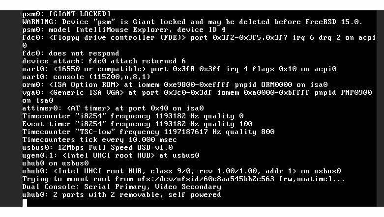

      • W Offline
        Wylbur @stephenw10
        @stephenw10 I'm having a similar problem, NOT using a *vm.
        I tried to just post in this area, but I was being forced to use "reply".
        I get "Mounting from zfs:pfSense/ROOT/default failed with error 6. (I have a picture of this, but I can't get my email on my phone to send the picture to my laptop where I am writing this).
        I have used a DVD with pfSense+ that reverts to CE, and I've tried the 2.8.0 and 2.8.1 options.
        So, with a working 2.7.1 from that DVD, I configured it and made sure I did not have any packages installed. Then told the running system to do the upgrade to 2.8.1 (to pull from the Netgate servers) and get the above failure.
        Not in a rush, this was my backup system that I am pushing (well, trying) to be the Primary firewall/gateway system making the currently running system my back up (should I need such). Just trying to figure out what is wrong and what is the command I need to use (if any).
        • stephenw10S Online
          So installing 2.8.0 or 2.8.1 from the net installer fails in the same way? 2.7.2 installs but then fails the same at upgrade?
          What are you installing to?
              Hmm, are there any other errors during the boot?
              Does it eventually fail to the 'mountroot>' prompt? If so what does it show there if you enter ? at the prompt?

                [2025/11/16 - 19:19:57.954]Trying to mount root from ufs:/dev/ufsid/60c8aa545bb2e563 [rw,noatime]...
                [2025/11/16 - 19:19:57.954]ugen0.1: <Intel UHCI root HUB> at usbus0
                [2025/11/16 - 19:19:57.955]uhub0 on usbus0
                [2025/11/16 - 19:19:57.955]uhub0: <Intel UHCI root HUB, class 9/0, rev 1.00/1.00, addr 1> on usbus0
                [2025/11/16 - 19:19:57.956]Dual Console: Video Primary, Serial Secondary
                [2025/11/16 - 19:19:58.458]uhub0: 2 ports with 2 removable, self powered
                  stephenw10 Netgate Administrator @bozo.bogd
                  @bozo.bogd said in Upgrade 2.7.2 to 2.8.1 frozen:
                  It looks like you're connected to the serial console there but the video console is primary? It's probably throwing some error at the video console that you can't see. That should show you why it's not booting.
                  https://docs.netgate.com/pfsense/en/latest/troubleshooting/boot-issues.html#booting-with-an-alternate-console
                  W B 2 Replies Last reply Reply Quote 0

                          • B Offline
                            bozo.bogd @stephenw10
                            We are watching output on both, serial and video (VNC).
                            Outputs and errors are the same. Nothing new.
                              Hmm, how are those VMs configured? I've run that upgrade numerous times in Proxmox and never seen that.
