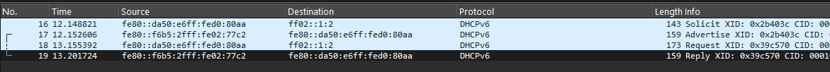

      I have been going in circles for days trying to get IPV6 to work. IPV4 is working fine, and right now most of my network is just IPV4. Cloudflare has marked every single subnet I've been on with Verizon FIOS for the past year as "abusive" and I've had enough of the 'prove your human' nonsense wasting my time. I'm switching to IPV6 for my public traffic one way or another.

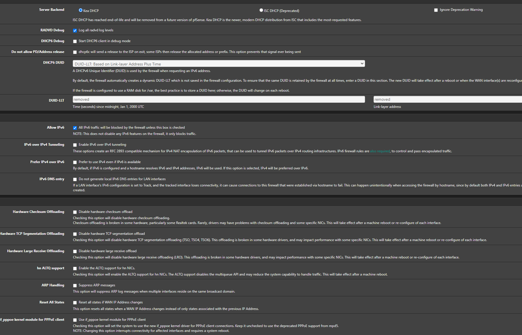

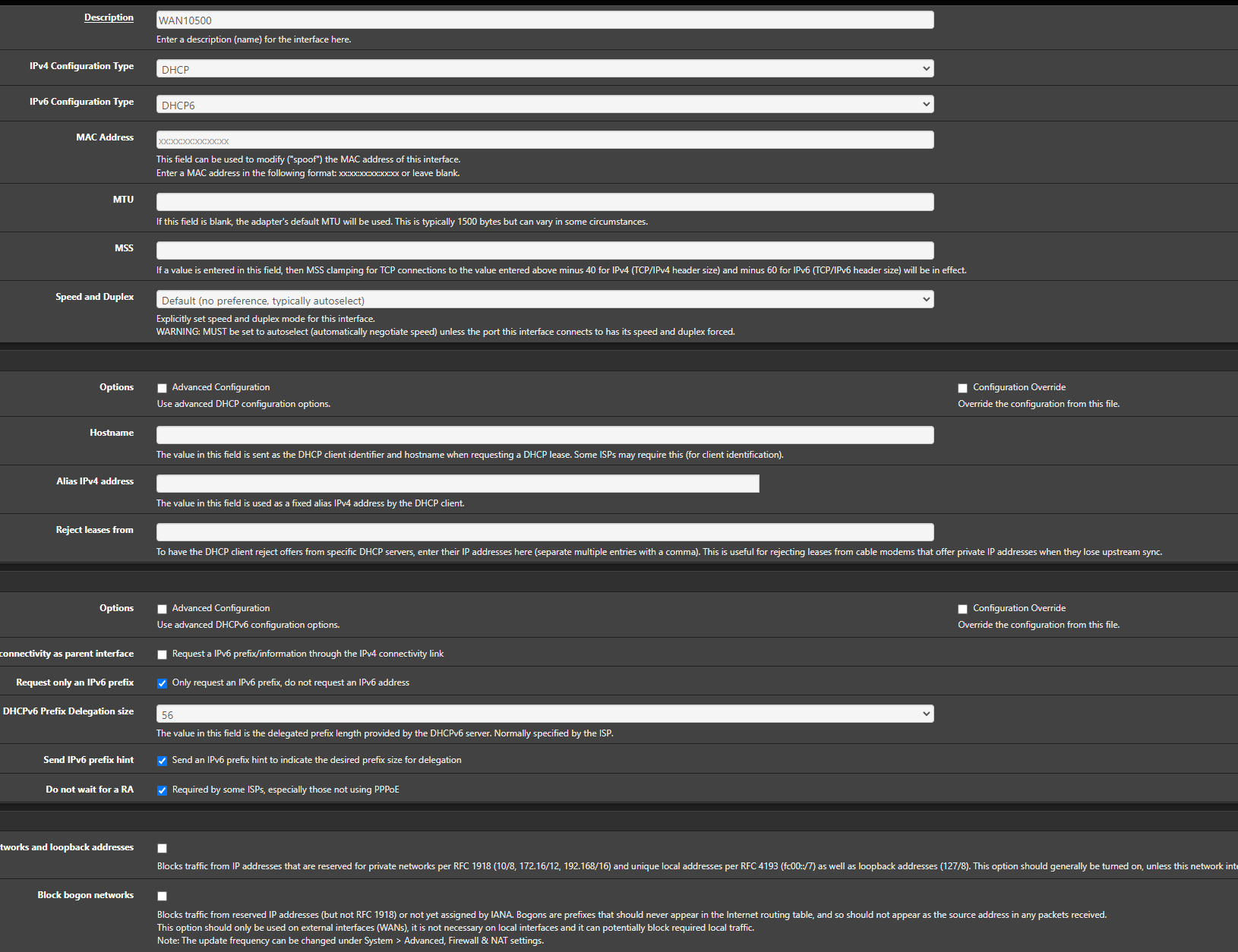

      I have tried virtually every possible variation of settings on the WAN interface (ixl3) to get a prefix from FIOS. It looks like in packet captures on the WAN the request is going out and getting the appropriate response from the ISP, and then something happens with /var/etc/dhcp6c_wan_dhcp6withoutra_script.sh, it's fumbling and dropping the response somehow and starting over. I've confirmed cli that the script is there and verified the contents. The file /usr/local/etc/dhcp6cctlkey is used by the dhcp6c FreeBSD for control port which is not a feature used by pfsense, at least that's what I was able to find. I've even tried disabling LLDP on the nic, which is a 4 port 10GB Intel X710. I know that for some ISP's having a link local address on the wan is normal (I guess cgnat?) but FIOS I don't think does that, I can see in the DHCPv6 pcap that fios is attempting to assign an IA Prefix assigned with length 56 and prefix address startign with 2600:4040: (7200 lifetime). I cannot ping or make any connections over the wan via IPV6 from cli on pfsense while it has a link local address.

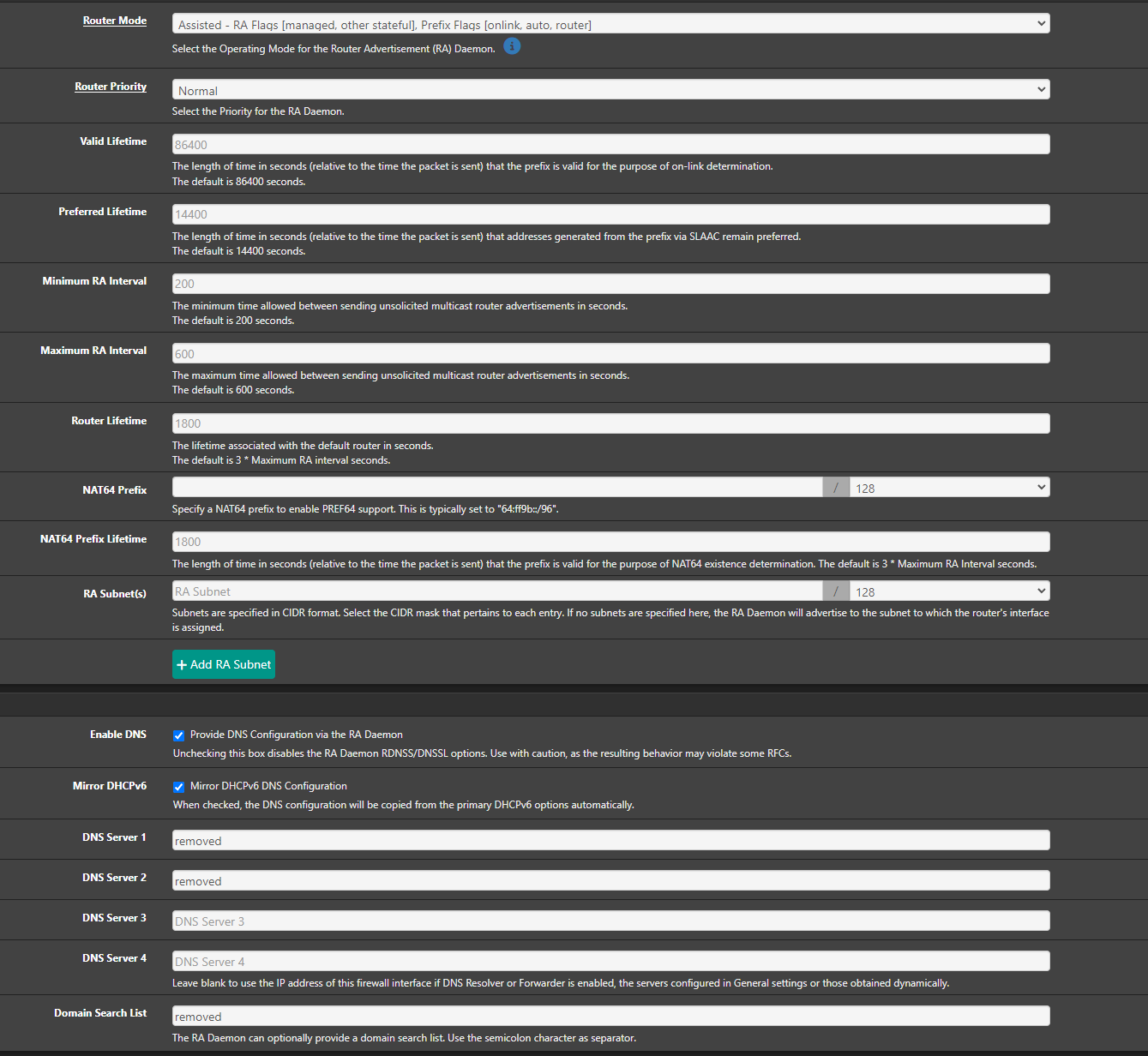

      I've tried configuring the other IPV6 related settings such as router advertisements, dhcpv6, etc, but those should not be affecting the initial step of WAN getting assigned a prefix via DHCPv6. I know that the ix drivers on this version of freebsd are very outdated for the X710 firmware version, but since I see it sending and receiving IPV6 packets on the WAN and successfully acting as a DHCPv6 server on the LAN I do not think this is involved.
      Appreciate any insight to the problem, or any additional troubleshooting steps. I am hoping someone sees this and already knows the problem. Thanks.
