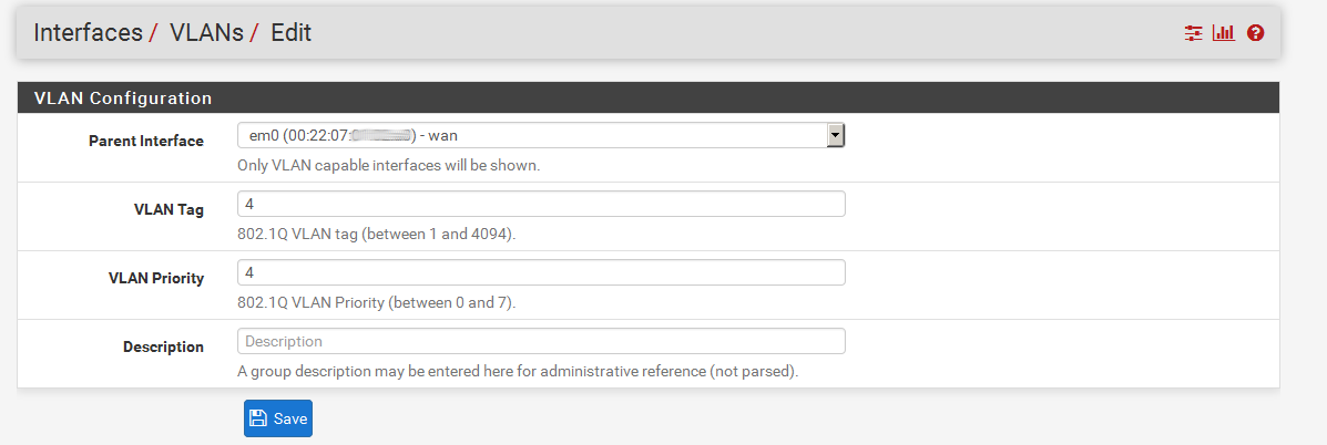

          @pjaneiro you should not bridge your WAN and LAN for IPTV to work. You should have VLAN 34 tagged on your WAN interface (if you're with Aliant, it's a different VLAN for Bell) and your routing should be setup per my post above so that IPTV multicast traffic is passed to your LAN port.

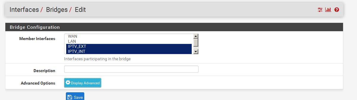

                  @autumnwalker Hi, my pvr is connected to a separate NIC on the pfsense box directly, igmp is enabled on pfsense, but if i do not bridge wan iptv interface with the nic, the tv does not work, when rebooting the fibe pvr and for the green light takes a while to become solid...

                    pfSense is not a switch, it is a router. You can configure it to work like a switch with bridging LAN ports, but out of the box it doesn't work like a switch and it isn't intended to.
                    Over simplifying - each port is intended to have one function (VLANs are a different discussion), but think of each port of being either in or out and each in / out is a different network location / segment. If you have WAN in from Bell on one port and LAN out on another port that routing is configured in pfSense automagically on initial setup. If you add your IPTV box to another port on pfSense it doesn't automatically know how to route the traffic. When you bridge it to WAN, it basically just puts your IPTV box in Bell's data centre - it isn't intended to function that way.
                    The "right" way to do this is to have WAN in from bell with VLAN 34, 35 (for Aliant users only) and a LAN out (no VLAN required). Put a switch behind your LAN port on pfSense (make sure it does IGMP snooping), and plug your IPTV boxes and all your other network gear into that.
