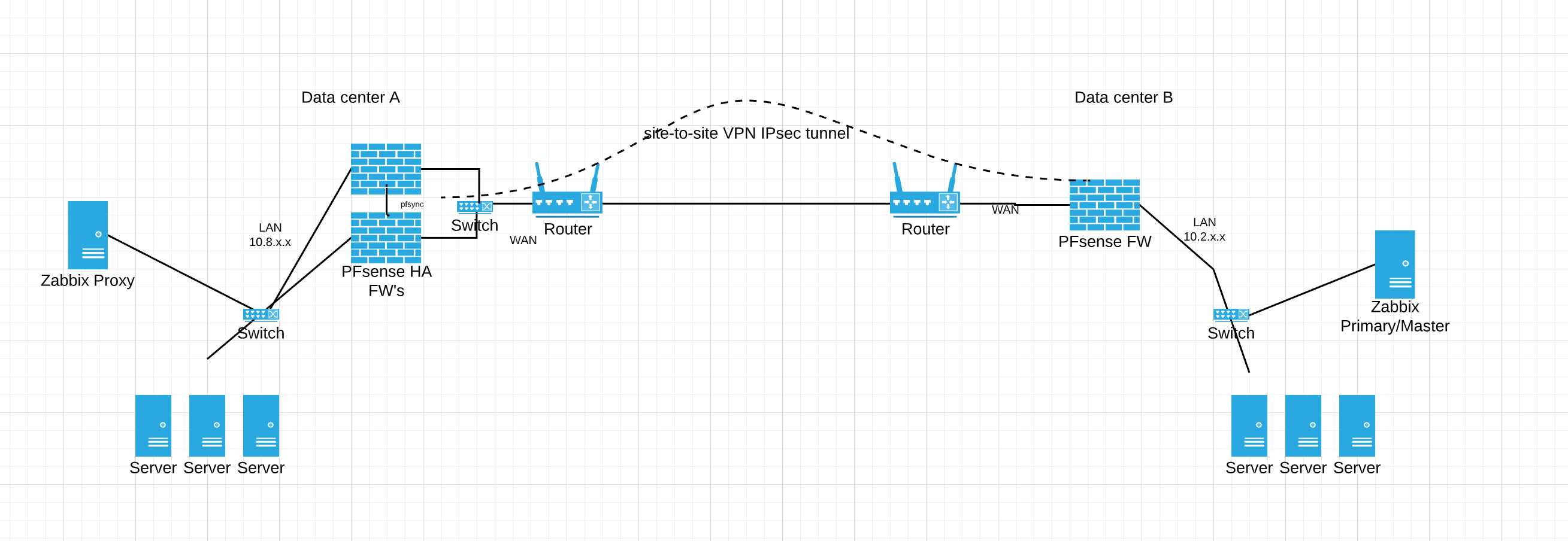

  • TCP Issues on Remote End of HA Pfsense IPsec Tunnel
    DerelictD
    @rivest1000 That should be fine. Sounds like you need to simultaneously capture an interesting connection on all three inside interfaces and see what there is to see. Sorry but it's something unique to your environment based on what I have so far. Are the missing FIN/SYN packets being sent to the primary while the secondary is MASTER? You're POSITIVE the zabbix hosts have the correct default gateways for the necessary traffic?
