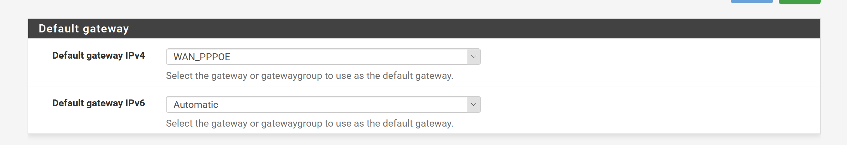

  • pfSense 2.5.0 Upgrage - OpenVPN Client Issue Fix
    542 Views
    jimpJ
    The upgrade wouldn't have changed the gateway, but it's possible the gateway selected by the existing "Automatic" process changed to one that wasn't your preferred WAN. Setting a specific default (single gateway or failover group) is more reliable, so your suggestion is still a good change to make.
