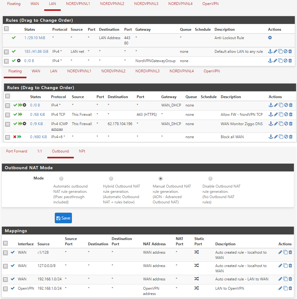

    290 Views
    To ensure the LAN rule with the NordVPNGatewayGroup will be applied you have to lift it up to the second position. Otherwise the rule allowing LAN net to any will be applied and the traffic is directed to the WAN GW.
